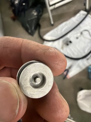

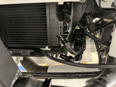

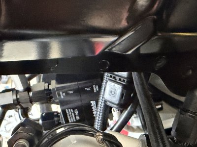

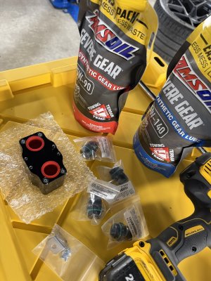

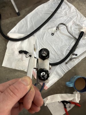

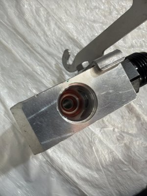

I will likely wait but a valid work around is convert the bypass block into a dumb pass through. IMG E3BF20E7 91DF 473A 9C38 F344DB4083D4IMG 9351IMG 52311C4D 4BD1 46BC A649 2BCA395C8F42IMG 27B0BBFD 93E5 48E2 9665 8264C93585A1IMG 500187DA DD58 4796 AC2B BE7679C615B1IMG DEA03908 414D 4722 8857 2D7111315FC9IMG 695D4448 62E2 490B A41A 93F75948B647IMG 38AC2FED FFBE 4844 964A 578F66B528EB
Tempting but threading in the return hard line would be super annoying and janky to have 2 bypass blocks, one as a pass through and the one with the brain up front.

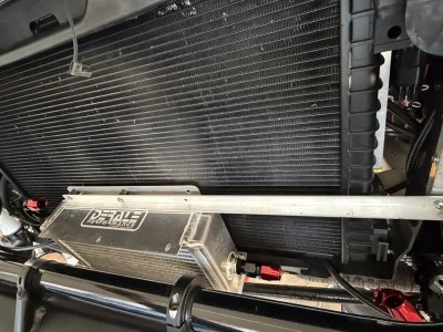

Mocking up the Improved Racing with just one bracket to see….and using a hole already in the core support, it looks like it was meant to be. Also I have a small inventory of used -10AN fittings and hoses and they are all reusable. So don’t need to buy a 90 or 120 degree. IMG 9352IMG 9353IMG 9356

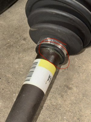

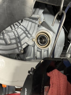

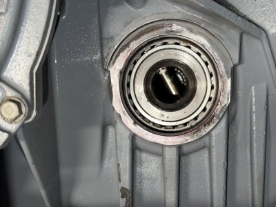

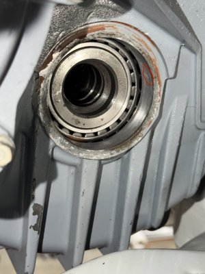

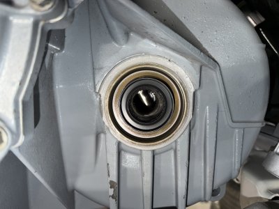

I removed my axle and it was actually weeping axle grease. Quite a bit. Literally would have started slinging grease next drive. If you remember I painted my original axle and was using it for Nostalgia…lmfao. Well it’s trash so buh-bye. I’ll use the brand new one again. IMG 9362
That’s after I wiped it all off.
JB Weld going in tomorrow and these gouges will get filled once and for all and put an end to fluid weep passed the seal. Already had a new one on hand. IMG 9360IMG 9361
And I’ll run some Amsoil Severe gear while I’m under here in the PTU and RDU IMG 9307

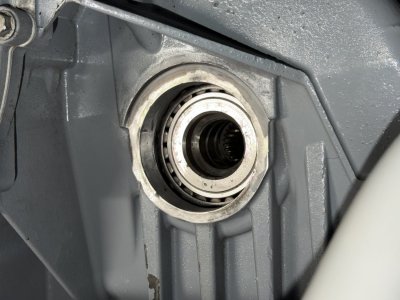

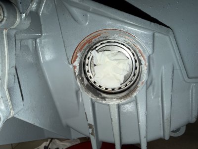

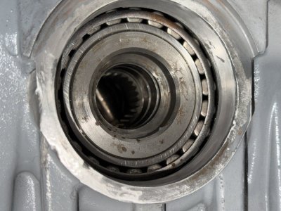

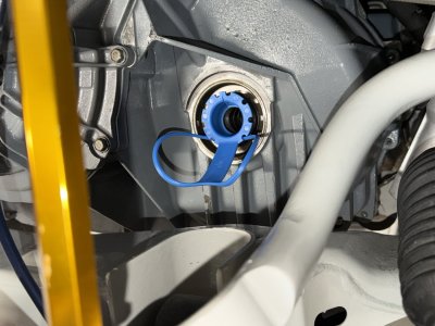

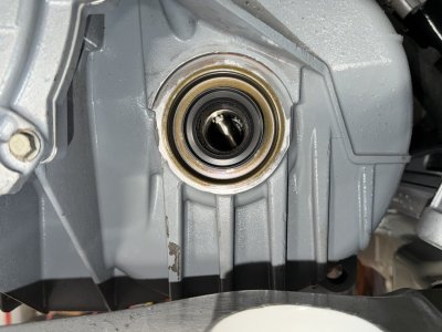

Axle housing and seal are done.

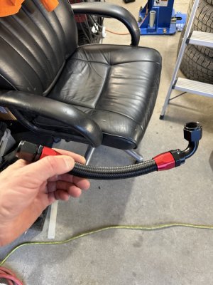

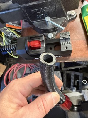

I did one more application of JB Weld SteelStick and messed around making some AN hoses while I waited. IMG 9378IMG 9381IMG 9382IMG 9383IMG 9376IMG 9377

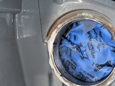

Polished up the housing after smoothing my 3rd application of SteelStick. IMG 9385IMG 9386

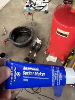

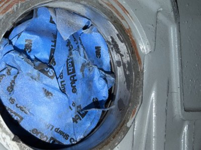

This is where I went one extra step. Anaerobic gasket maker, cures in the absence of air. Fills microscopic imperfections. Just a tiny bit…you’re doing it right if you question if it’s enough. Inner bore and outer mating surface. IMG 00765C0E 10BD 46BE A410 599018648158IMG 9391
Used this plunger with a hammer. Don’t want a rubber mallet here. Mallet absorbs energy a hammer transfers energy. I started it by hand just a little which was awesome. The refinished bore + anaerobic sealant helped for sure. IMG 9392IMG 9395
“Glory Hole” seal protector ready and willing:laughcry:
IMG 9396
This was the 3rd shaft seal job I did here. 1st time I thought it was bc it was an aftermarket seal. During that job pretty sure I added gouges to the housing on accident…then second time was trying to figure out why the new OEM Ford one leaked and I tried some sealant to fill in imperfections and did very light filing of the sharp edges of the gouges.
This was the 1st legit repair. 3rd times a charm

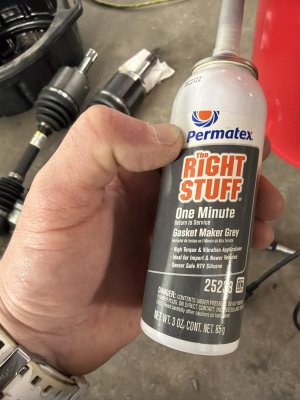

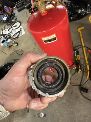

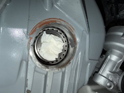

I couldn’t resist. IMG 7EACB925 FE1F 4E7D A371 E10A91FC1189 Call it PTSD. Or call it extra insurance.
IMG 9407IMG 9411Small bead of 1 min gasket maker all the way around bc this it the moment it’ll actually work. It’s dry and clean and drained enough there’s no fluid contamination.
Now take a look at the before. I used this 1 min gasket maker in a panic with no room to work with plus and active leak and it stopped it 90% in its tracks. IMG 240D08CB 8E6E 489A B231 08E5BD98840E
That nasty left side gouge was the problem child. This was never a seal problem, it was a bore problem.
Now it’s repaired properly, smoothed properly, sealed properly, new shaft seal inserted properly and 1 min gasket maker as cheap insurance in an application that counts. Win.

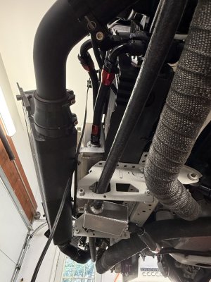

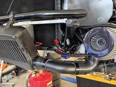

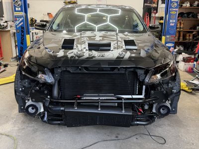

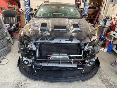

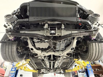

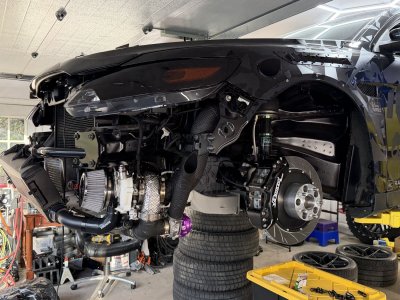

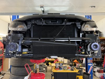

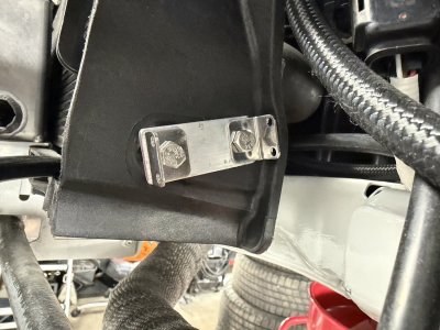

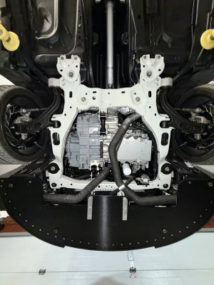

Improved Racing 185 mounted solid IMG 9413IMG 9414IMG 9415IMG 9416
Just barely clears in the back. Perfect IMG 9420
Evil Energy gave me some hoses a while back that’s where I got the red from. Mocked up ready to cut hoses. Also going to move my trans gauge thermostat to the feed to the trans. IMG 9421IMG 9419IMG 9418

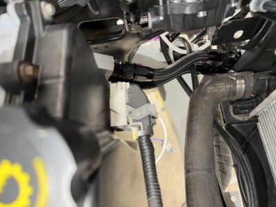

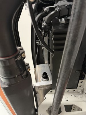

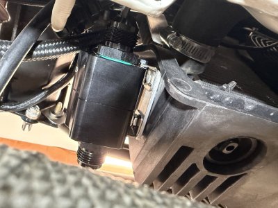

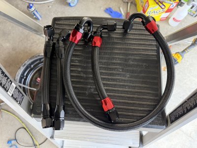

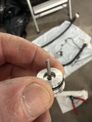

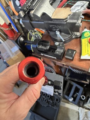

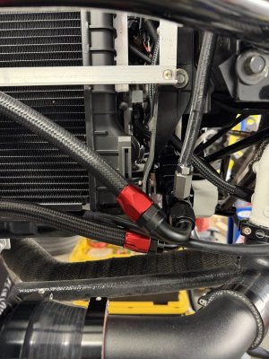

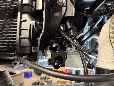

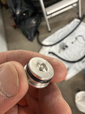

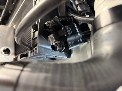

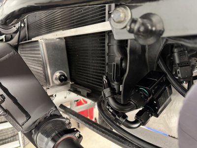

Ended up using the dumb pass through. No clue when the fittings will show up. Can redo over next winter. Made all my hoses. IMG 9431

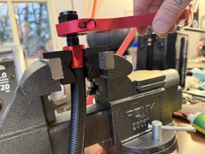

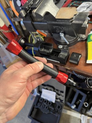

Ended up making the all black hoses straight female fittings on both sides IMG 9442
Put the feed to the cooler up top and the return on the bottom. This will push any air out of the system a lot easier. Also put my manual transmission temp gauge on the cooler feed. I don’t need to see how much cooler it is on the return lol. IMG 9438IMG 9437IMG 9440IMG 9444

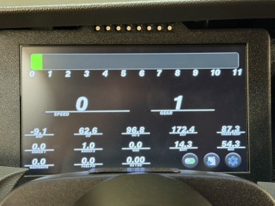

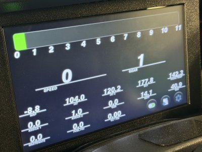

Observed temps raised about 20 degrees idling. I didn’t drive it. I’ll wait. ECT (Engine Coolant Temp) raised to 186 and I turned my fan on. At 180+ I’ll turn my fan on. This was my first real test. Would the trans temp drop with ECT with the fan on?
Nope! ECT dropped and trans temp kept climbing. That’s a mini win. IMG 9450
I think it’s going to warm up as it should now. Next dry day it’s getting driven.
David is waiting on me but we will continue chasing some PID’s before I do my final Custom screen layout.
Can’t wait to test drive this. IMG 9453

I just took it out after remaking trans cooler lines and using the new Improved Racing 185 thermostat/bypass. Rain ruined it. IMG 9483IMG 9481 But it appears to be working now. Got temps up to 142 and my fan didn’t bring it down. IMG 9482Eventually idling long enough it does settle and maintain a temp. Maintained at 142.8 idling only. Each actually drive brought it up and it stayed up. However the fan doesn’t bring the temp down anymore.
Ryan sent me my 4th revision base map and it felt much better with even low load on responsiveness + the transmission seemed to match it, shifting faster/sooner. He disabled the cruise control module and I have no codes finally!
I was trying to get temps up to 180 to set the fluid level. At 142 it looks good I think 180 it’ll be perfect as it expands a little more.
Thursday it’s going WOT. I’m off from work the rest of the week and Thursday is going to be a sunny day.

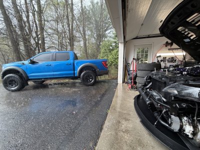

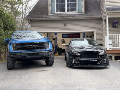

Posed with the Raptor for a pic before rainIMG 9480
I did the RDU fluid swap. I’ll do the PTU and alignment with my Gyraline DIY tool tomorrow. I decided to wrap the front and bottom of the Straight Boost Performance TT scavenger oil tank lol. IMG 9475
