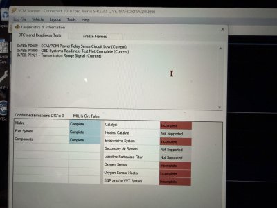

Checked codes this morning. I haven’t checked them since I started driving it again, so this is after 4 different drive sessions. Also worth noting, these are the first real drive sessions with HP Tuners, so just because I’m seeing the TRS code now does not automatically mean it’s the first time it’s been there. It may just be the first time I’ve actually had the right tool looking deep enough to see it.
P1602 is gone.
P0685 is gone.
P0689 is still here.
And P0689 matters because I did see that one back in September with SCT when the car went into limp mode on my way home from a job site. So I’m treating these codes as legit. HP Tuners is showing me truths SCT never had the depth to show.
So before I throw parts at it, I need to chase P0689 honestly.

David was successful at finally polling the PCM for gear select position and now I have this TRS code. At a quick glance that is the sequence.
It’s not normal for my car to show gear select in my cluster so I’m just curious requesting that while the TRS is trying to work and be left alone, to me, muddies the water.
When I replace fuse 11 and check out the terminals, I’m also going to turn that function off in the dash. Drive and see what codes come back.

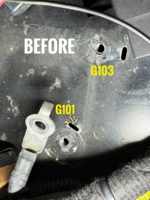

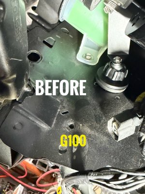

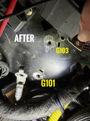

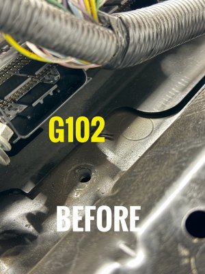

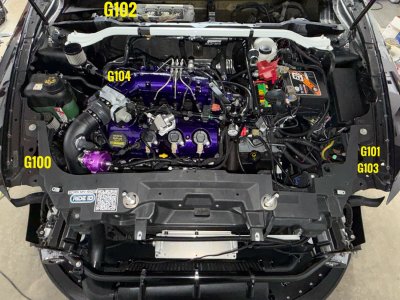

So I found one…ground on powder coat. IMG 29EF6988 B75F 4175 AD9A FED324515556
I painted the engine bay…
Motor is painted….
powder coat on the timing cover, valve covers ….
my transmission is painted……
The car is insulated from itself. This new find has me second guessing the others I “fixed”. I’m going to use my dremel with extension (it’s like holding a pen) and sand barrels to go around and redo every ground. Once done I’ll tighten it good and to protect it, one shot of matte clear or gloss clear depending on what the surface is. Then it’s metal to metal and top coat is protected from oxidation.
The car looks fantastic…hey why is it acting weird? Idk did you prep the ground surfaces? Did I do what?
…Exactly.
This 11.06 Record is going to get thrashed when this thing isn’t insulated from itself anymore lol IMG 9017

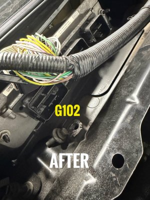

I did prep to get ready to redo grounds here is my layout. All I wanted was 1 hour and take for a ride. When it started raining while I was at that job much longer than I wanted to be I was so agitated. lol.

All ready just need to get to it. I put a new fuse 11 30A fuse in for the PCM relay. Clear codes after and take for a drive with the dash not polling the range sensor and see what codes come back. At least I want to make sure P0689 ECM/PCM power relay circuit low to be gone for good and then it’s swap hardware if the range code comes back.
The range code baffles me bc it failed and then it passed the ohm test. But the dash did poll it for position. That should not matter but I think it exists where for whatever reason it doesn’t like it. I’ve seen crazier things. Only one way to find out.

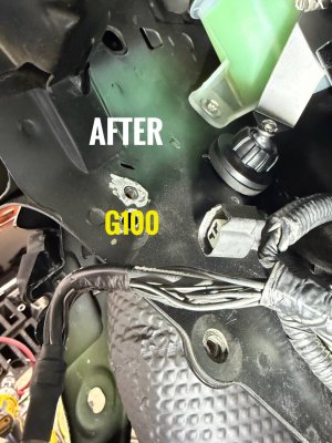

Ground 100, 101, 102, 103, 104….all insulated.
IMG 9043
IMG 9045IMG 9047IMG 9050IMG 9052IMG 9054IMG 9057
I expect this to make a 100% difference. If for some reason P0689 remains I have solid data to take diagnostics to next steps. Likely back probing the ECU. But….after this…? This was a massive correction.

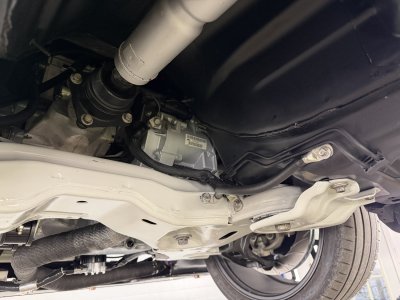

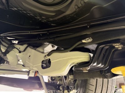

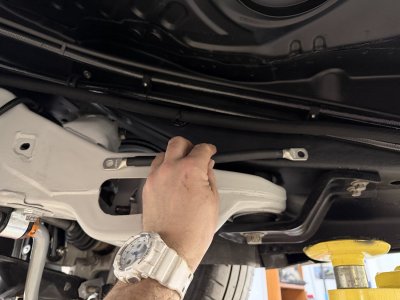

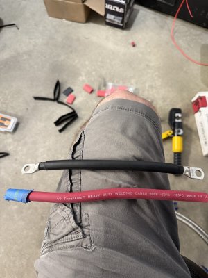

It’s deeper than this. Subframes are painted over and the unibody mounting points are painted over. I have isolated subframe islands. I built an invisible fence around the car suffocating its ground paths.
I don’t need to disassemble it. I’m going to add a jumper cable from the rear subframe to unibody and front subframe to unibody.
My rear battery is grounded to the rear subframe but it’s isolated from the unibody, finding only a weak path (whatever incidental metal-to-metal contact still exists between the rear subframe and the unibody) back into the main chassis/engine negative network.
This is crazy but makes so much sense to keep uncovering layers of painted/isolated ground paths. I painted everything

Diary entry 109/9. lol.
It’s been raining here way too much. I’m pretty close to done making my subframe to unibody cables. Here’s one I made, ends crimped and covered in heat shrink. IMG 9087
I’ll place it somewhere around here IMG 9088
Just need to make one more for the front.

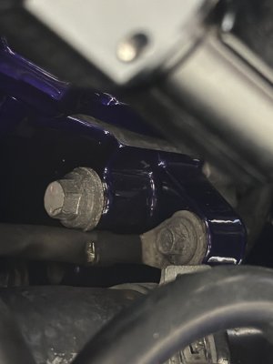

Thank you for all the critical ground locations. I did upgrade most of them, the ones that I could see, but that hidden ECU ground seems to be the culprit in my case. BCM and PCM read totally different voltages and the PCM voltage fluctuates heavily. Replacing the relay/fuse did not work.
What did you end up using to insulate the grounds so they don’t rust? I used Ford’s black touch up paint pen before but it honestly looked ugly.
The engine bay ones I hit with this Image
Under the car until I get more paint I just wiped this around them Image
Let me know how it goes when you touch up G102. Did you check fuse 11 it’s the 30A fuse to Relay 53. You can pop the clear cover off and probe it.
