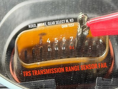

Ford TRS test procedure. Ignition on, brake, gear select M, ignition off.
hold pin 8 check resistance to pin 4,5,6,7. If any show more than 5 ohms replace TRS.
Pin 7 registered 0.L. It’s completely dead.
I retested it over 20 times. It’s failed.

That part finally stopped being a theory. Pin 7 failed. O.L. over and over. Hard fail.

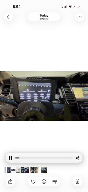

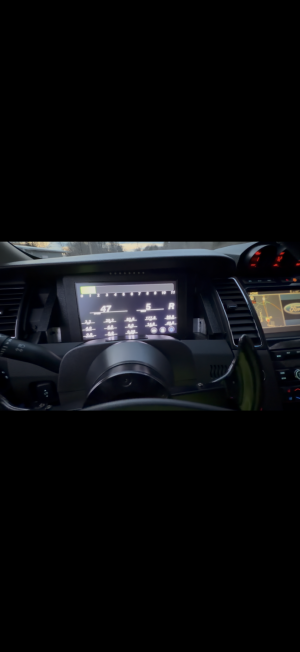

Gear select wasn’t registering yet but David sent me 4 revisions for the dash and we got it on the last try IMG 8935
That pick was snapshot of my taking a video gear select didnt work yet.
After when he got it working parked with the dash uninstalled. IMG 8933

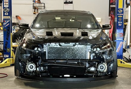

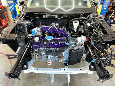

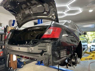

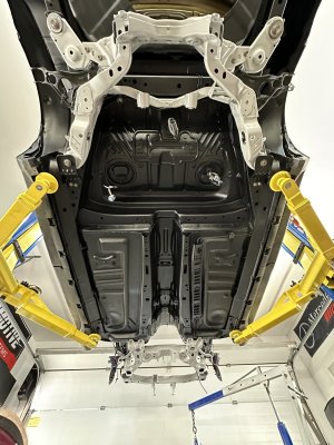

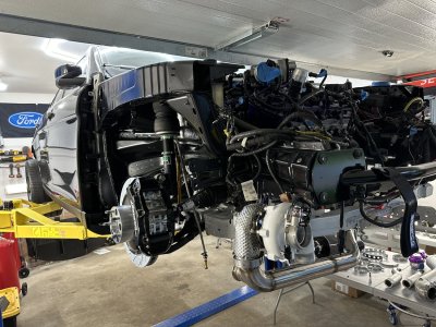

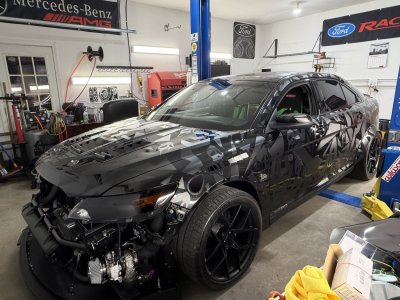

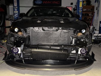

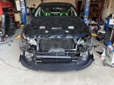

This is a moment of reflection. IMG 1374IMG 1454IMG 1469
Dropping this update with these shell pics because I think it helps explain what this car actually is.
I didn’t just bolt on a few parts and go make some pulls.
This thing spent years getting mocked up. Then it got torn back down to a shell. Then it got final assembled. So when I say this car had to be commissioned, sorted, and taught how to be itself, I mean exactly that.IMG 1541IMG 1412IMG 1437IMG 1553IMG 1555IMG 1559IMG 1562IMG 2240IMG 2251IMG 8746
Looking back, I can understand why a bunch of little things all stacked on top of each other. Painted over and insulated ground paths causing issues. A gear select cable that needed to be reset and indexed correctly. Loose EPS bolts. Loose rear subframe bolts. None of that sounds unrealistic now. Not after taking a car this far apart and bringing it back to life.
And that was only part of it.
This car has not just been driven for 700 miles. It has been sorted for 700 miles. Big difference.
Turbo oil return.
Primary O2 locations.
PCV VTA revisions.
VVT solenoid gasket nonsense.
Valve cover gasket issues.
Fuel sending unit false readings and running out of gas.
Frozen BOV piston
Wrong intake coolant gasket twice.
Around 6 oil changes.
One set of spark plugs.
One transmission drain and fill.
Three coolant drain and fills.
Correcting my FPR
And more…
That is not normal “I drove my car 700 miles” stuff. That is commissioning a custom build in real time.
And on top of all of that, I was still chasing hidden things stacked underneath making one problem look like ten.
Honestly the smartest thing I did was hold this car back when it didn’t feel right. In the middle of not knowing exactly what it needed, I stopped pushing it to run. I knew I had to help it walk before I had any business asking it to run.
That took an incredible amount of discipline but I also know what a very well dialed in setup is supposed to feel like.
Because now looking back, I’m honestly flabbergasted by how many little things were stacked on top of each other, and how wrong I was too but at the same time I’m more in tune with this car now than ever. In the middle of all of this, somewhere between the teardown, the sorting, the revisions, the diagnostics, and the restraint, I learned its language.
That’s what these pics really show.
Not just a build. A car that had to be commissioned. And right now it’s showing it’s ready. Only one way to find out.

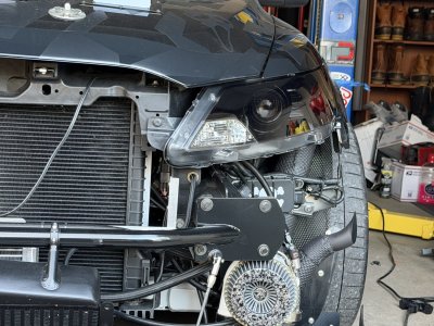

STEK DynoSmoke PPF on the new headlights. Had to jump through hoops to get some because STEK doesn’t sell to normal consumers, only to their “certified” installers.
That word gets thrown around a little too casually, because “certified” doesn’t guarantee talent, it just means you’re in the network. We only sell B2B (Business to Business) ok here’s my IEN number, for my drywall business and here’s my statement from Meta showing my income for my Creator content @802SHO. Oh then they instantly say we don’t do B2B, only to their certified installer network. I’m like ok which is it? I had to buy some from a certified installer….so you can buy it but not directly from STEK. This is a rant but I understand why….its supposed to be quality control but it never will be. The industry self regulates high quality products from bad installations. If it’s a great product, sell it. That’s the reality. Always was, always will be.
Only got one done last night. I’m leaving the blinker clear and going with clear LEDs so it stays clean and doesn’t look overdone.
IMG 8965IMG 8962IMG 8964
Edit: next morning. Wow, it looks like glass! I think it’ll look cool blacked out but clear blinkers. IMG 8969IMG 8967IMG 8968

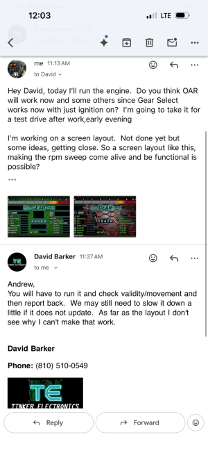

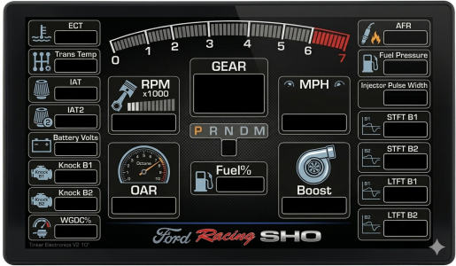

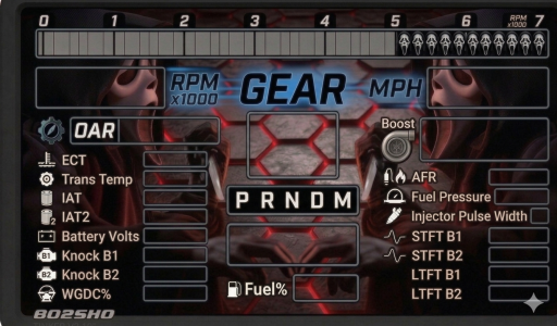

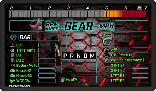

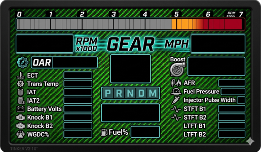

Now that I know the PID’s that I want are going to be available, it’s time for a custom screen layout for the Tinker Electronics V2 10” dash
Some ideas I got going. I think I need to keep editing 2FF94232 7A77 4661 BAEF B2DA65B6948EIMG 8942IMG 8945
Edit From David. He can make my finished layout functional for the RPM sweep up top. IMG 8972

Took these picks and I can hear buzzing again IMG 8976IMG 8977IMG 8981
The drive back was fine. Never lost mobility. Acted like it nothing was wrong putting it back in the garage IMG 8984
So..the slight improvement has me hesitant to throw parts at it that are on the bench.
