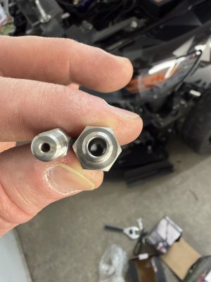

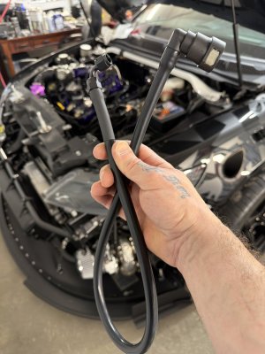

The FPR I swapped the orifice to the 1/8 NPT to -4AN. Made a new hose IMG 8775IMG CAA2A161 DBD5 4E87 AAAA F1F20200A0C8IMG 8779

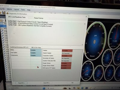

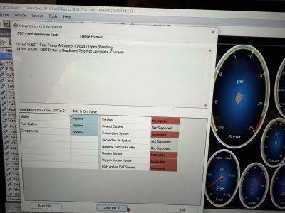

I also did some tests with my TCM power sequence and keeping it tight, powering TCM just before hitting start and firing up the engine that seems to keep TCM (fuse 49 codes) at bay. After about 15 min of idling and checking my FPR and 11psi BOV I shut it down and left TCM powered on….then I turned ignition back on and checked for DTC’s. IMG 8783
That fuel code will be disabled but I’m basically back to P1000. Which hasn’t been the case since 2020. Then I left ignition on, turned TCM power off and cycled the ignition off and on a couple times and rechecked…IMG 8784
Another fuse 49 related code. I’ll get P0685, P0689 or P1602. By playing with sequence of manually powering TCM on my switch panel I can make them go away or come back. So that’s great data. The bypassed BJB powering fuse 49’s load path works and if my sequence isn’t tight it gets flagged.
Which leads me to believe fuse 49 being dead and not tied to ignition is the reason for the codes coming and going. My next verification is to use a slot on my switched 12 volt distribution block to jump power to fuse 49 again…bc I believe it will allow that load path to register at all times. Ignition on with the real direct power off manually and with engine on and it manually powered externally out of the BJB. So at all times it’s satisfied but also it’s legit powered only when needed.

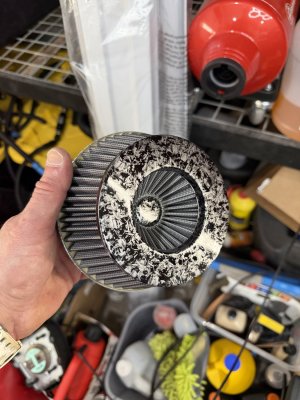

I wrapped the front chrome on my new cone filters with the same vinyl as my interior trim panel above my deleted glove box. IMG 8766IMG 8767
Looks good. I really like the white filter media. IMG 8759IMG 8768IMG 8773

Quick add to the FPR explanation. The concerning gauge reading that warranted me looking into it was:
-70psi manifold referenced at hot idle.
-80psi on throttle stab
-60psi throttle lift transient drop
-70psi constant fast recovery (in the gauge)
-TPS signal increase/decreases pump speed
-manifold reference on throttle stab decreases vacuum and increases regulator pressure
-manifold reference increases vacuum on throttle let out
-TIP in is rich. Trims remove fuel and wideband go lean.
-gauge shows that big transient dip
The equivalent of a true 60psi reading on that pressure gauge would equal -40 inHG the way it’s set up. It’s a transient undershoot the gauge exaggerates, not a true steady 60 psi condition
All is good and for a base map TIP in being rich is tunable. Load is the real metric anyway. Thats when the numbers hold the most weight.

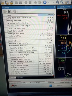

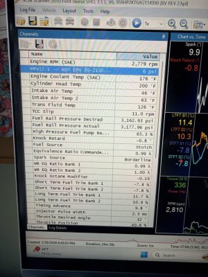

I need to get used to VCM Scanner, navigating it to separate PID’s and graph them. I was looking for EMP from the Rife sensor on my mild throttle and here’s a great snapshot.
IMG A514E9E4 9AB0 4E7D B463 5F66D0701B59IMG 24437E4E 69CC 4688 82BE 192B9F133AD5
One clean snapshot from the log:
58 mph
2779 rpm
40.8% throttle
1.40 load / 1.36 desired
MAP 22.5 psi absolute
Baro 14.6 psi
= about 7.9 psi boost
At that same moment the Rife EMP channel showed 6 psi, so the sensor is alive and giving believable data. Real load will show the truth but mid throttle that’s 0.76:1 (Drive pressure to Boost). (6) : (7.9)
High pressure fuel:
3162.93 desired
3177.96 actual
Widebands:
0.99 / 1.00 lambda
STFT:
-7.8 / -7.8
LTFT:
11.7 / 10.9
Spark:
9.8
Knock:
-0.8
That one frame says a lot.
EMP channel works.
Boost math checks out.
Fuel system is doing its job.
High side is tracking where it should.
The data actually makes sense now.
For a first useful road snapshot, that’s good.

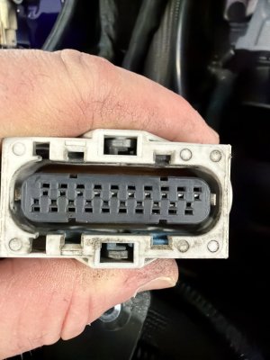

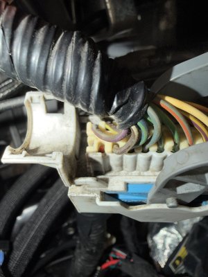

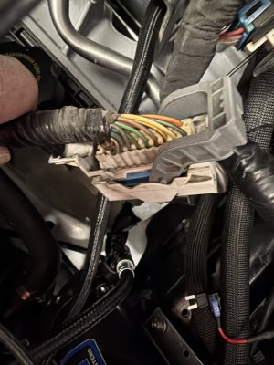

I bought the 14g wire, the mechanical relay and I already have the rest. I started to get ready to de-pin pin 9 and averted to hold fast.
IMG 96CF3FE3 1839 4103 B5A8 8A972EA79092IMG 679C4E94 1D11 4BB9 9109 3D2D5405E789IMG 8853IMG 8856
Facing the connector
Top row left to right is pin 10-1
Bottom row left to right 20-11.
My build date is October 2009. Legacy shit
Power probe 3 KOEO
Top row
10 = no beep, 4.9 V — OSS sensor signal
9 = beep, 0.0 V — TSS/OSS sensor ground
8 = beep, 0.0 V — TR sensor ground
7 = no beep, 11.4 V — TR4
6 = beep, 12.0 V — TR3
5 = beep, 12.0 V — TR2
4 = beep, 12.0 V — TR1
3 = beep, 0.0 V — TFT signal return
2 = no beep, 4.4 V — TFT sensor supply
1 = beep, 0.0 V — Shift Solenoid E (SSE)
Bottom row
20 = beep, 12.1 V — TSS/OSS sensor power supply
19 = no beep, 4.9 V — TSS sensor signal
18 = flickering beep/light, 1.2–1.6 V cycling — Line Pressure Control (LPC)
17 = no beep, 2.0 V — Shift Solenoid C (SSC)
16 = going crazy like 13 did — Shift Solenoid B (SSB)
15 = beep, 12.3 V — Transaxle solenoid power control voltage
14 = no beep, 2.0 V — TCC solenoid
13 = no beep, 2.0 V — Shift Solenoid A (SSA)
12 = going crazy like 15 and 13 did — Shift Solenoid D (SSD)
11 = no wire / unused cavity — Not Used
Hold fast is MF right. Pin 9 was not correct info.

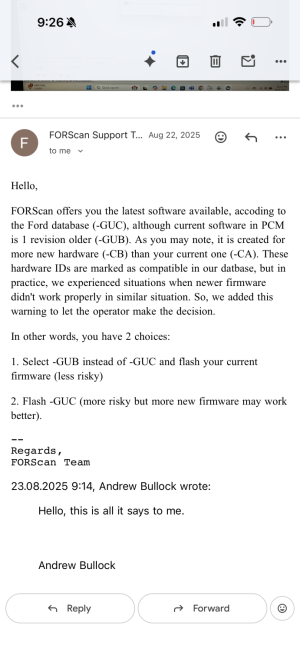

Let’s take a trip back in time. Forscan memory lane I flashed GUC. IMG 8857
More risky, sounds fun, maybe not.
Found one body of work through Ford that if PIN 15 shows more than 10 volts—change solenoid assembly. However I did not perform their exact method so to just jump to more than 10 volts — replace is not exactly correct.
Order or new operations:
1. strategy / programming mismatch on the currently installed hardware
2. external connector / harness / terminal-fit issue at C168 or nearby
3. current installed solenoid body / valvebody / trans-side hardware issue
4. early-build TSB TR-sensor issue
5. PCM
Blunt version: the TSB mostly points inside the transmission-side TR sensor circuit, but your swap/update history makes that specific early-build bulletin less likely than software mismatch or connector/harness problems on the current setup.
I have the problematic 2009 stuff and harness plugged into hardware meant for an updated firmware version that’s inside a ‘14 transmission. Flashing the new solenoid assembly back from GUC to GUB firmware my car supports is the next cleanest path. Then hard reset…and electrical checks before any Cowboy shit
