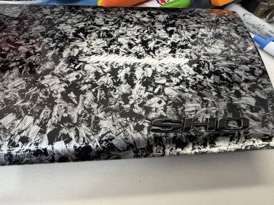

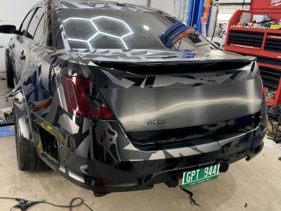

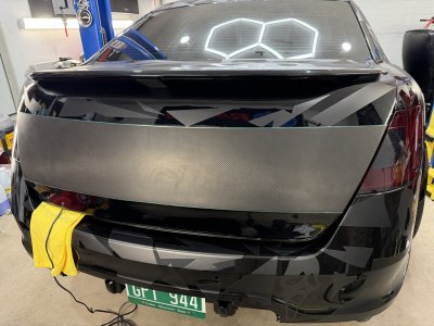

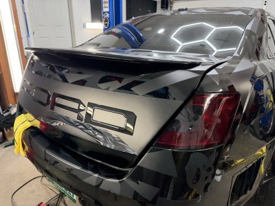

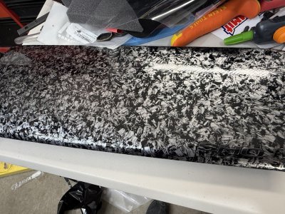

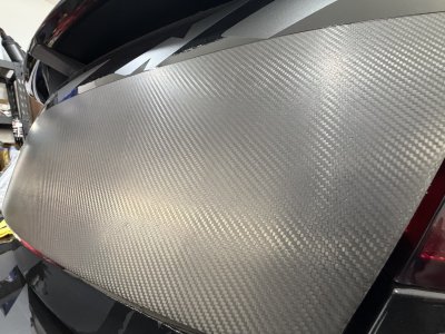

Meanwhile I removed my Ford truck lettering and switched it up. IMG 8584IMG 8644
raw carbon underneath. Too bad the finish wasn’t good enough for paint of a couple holographic creases left behind from transport IMG 8585
Knifeless tape IMG 8586

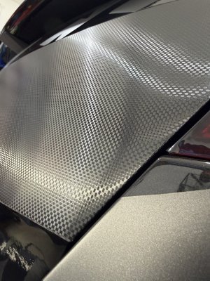

This looks really close, Vvivid black square CF vinyl (what’s used everywhere else for CF) IMG 8616
Added the original SHO lettering from the OEM badge panted black IMG 8609IMG 8612IMG 8613
Also wrapped the panel above the deleted glove box IMG 8621IMG 8622

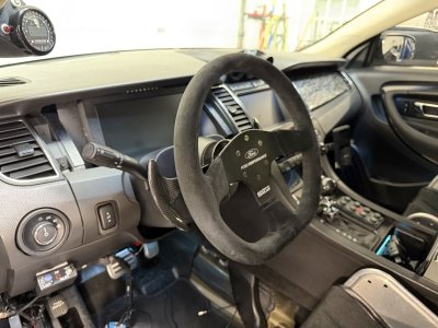

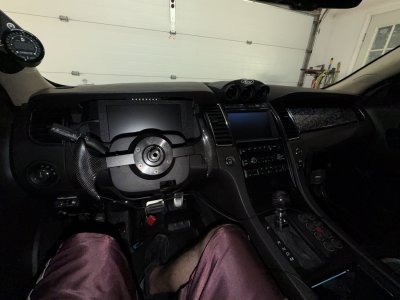

Then I added 3M Matte PPF (anti glare) to my infotainment screen and Tinker 10” digital Dash IMG 8625IMG 8642IMG 8638
Now back to waiting for Ryan from EMS and David from Tinker Electronics

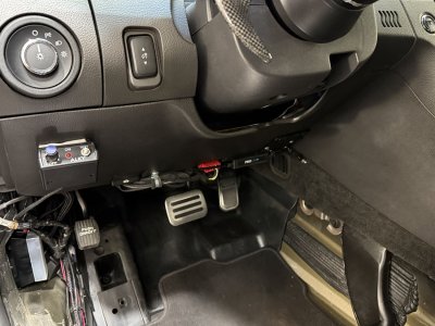

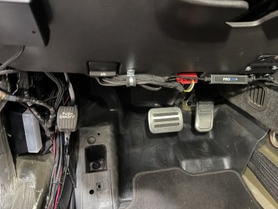

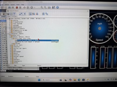

Last night I rewired my Prolink+. I had the Rife ground, Prolink+ ground and Converter ground all connected and relying on the MPVI3 plugged into the OBD2. I couldn’t remember which Prolink+ signal wire I used, I thought red but maybe it was blue. So I tested both and they both registered whack numbers -0/0 -0/1 idling. One didn’t have signal but could be a ground continuity issue, it was messy and unreliable.
Went back and opened it all back up. It’s now:
Rife ground, Prolink+ ground and 5V converter ground — chassis ground in the interior.
Rife signal (white) — Prolink+ signal (Red).
Rife Power (red) — 5V converter power (green).
Interior wiper motor switched 12 volt —power distribution block.
Converter 12 volt and Tinker 12 volt —power distribution block.
The power distribution block bus I wanted to test the Tinker dash on the slot I used to have the Converter power on last time and the Tinker dash powered up KO (Key On)
Ran out of time so later today I’ll retest the Prolink+ external input Rife 300psi sensor idling. It should read from 0-2psi, a range that could make sense but since boost is - it may be 0. Need a drive to really see. But at least now my grounds are shared on the chassis ground and I know it’s the red signal not blue.

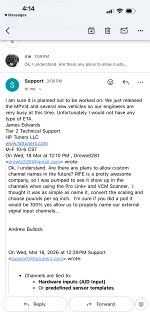

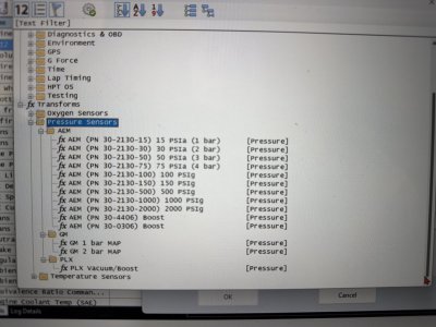

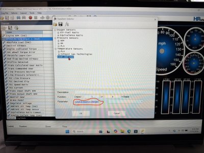

One thing in VCM Scanner. When you add the sensor. It allows you to transform and AI gave me the scale, but you’re then forced to choose from a prelist of pressure sensors and the AEM 500psi is the closest. With my scaling for 0-300psi and description of Rife 300psi EMP, it populates to channels labeled as AEM. That’s absurd. IMG ABDCDA33 64B8 4C5F BD6D DEB1EABDBF0BIMG 7A5D5D04 AEE5 4969 8642 F26F16BC044AIMG 6963E462 7040 4603 A5A8 005529F3138FIMG 9A053FBB DADC 42B7 8994 516E306F63C4IMG 0BB1FA7A 4905 4E44 ACD0 8A4C0969A6C4
I’m actually interested in nerding out here and I can’t stand that I can’t label it and have it populate to channels as Rife 300psi EMP. I reached out to HP Support bc correct labels is not asking for a Moon Landing. IMG 8555
I’m not sure why you can’t just add your external input, label it, scale it and choose unit as in PSI and done? But at least I got it on their radar.

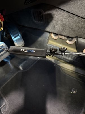

After the wiring was done I used some mini ZBAD1 magnets to secure the Prolink+ out of the way for easy access. IMG 8686IMG 8689IMG 8691IMG 8693
If I need more switched 12 volt I can easily grab it here, 3 more slots up for grabs. IMG 8684

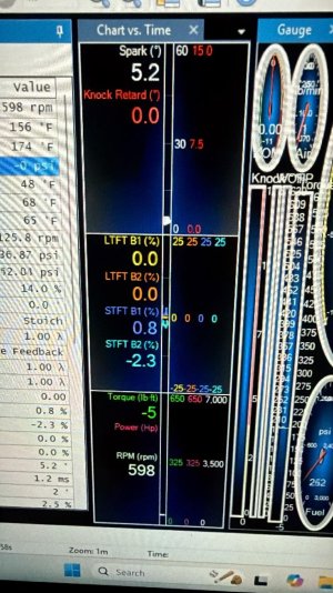

Map scaling was wrong. Now it’s correct. Dead system DTC baggage is also cleaned up. Massive improvement and no idle dip or choke. AttqLKMNIgsLlDmvQKDdQGN3wB3pOkLLC1 KgKmLM0vIJw
The idle log Ryan reviewed back in November was rich bc MAP and TIP were not both scaled to 20.167 -2.162. It was hunting or guessing yet KOEO was showing no gross sensor mismatch. Yet when Ryan reviewed the original base map idle log he then instructed me to give it a drive. Do a steady state light throttle input and WOT blip. With a baseline that was already lying.
I have learned so much but honestly I never had LTFT and STFT issues so I could stare at it and think…nothing really. I could see Lambda and notice Brad kept it at .80 WOT. I’d just see a pattern. When I learned more about Lambda getting involved in considering my primary o2 sensor placement wasn’t good enough…to move them post turbo is when I really understood Lambda more. In simple terms like usually GDI EcoBoost run .85 and that’s leaner. Brad likes .80 and likes to say it gives margin and also has a cooling effect. So leaner hotter, richer cooler….ok. But bc of my o2 placement post manifold the error was going to show leaner than actual. So Brad’s .80 in logs was likely .76-.78. Super rich. Explaining the black smoke on WOT (blacker than regular catless downpipe) and very strong fuel smell.
After moving them post turbo with premium wideband extension harnesses I had Brad target .82 and that was in the middle of what he liked and what it could have been .85. But still STFT and LTFT…dunno what I’m looking at bc never needed to know specifically.
During the stumble I had ChatGPT5.4 look at some parameters and my LTFT and STFT it red flagged. Car was consistently removing 20% fuel. I look back in the original base map log bc now I learned what the **** it means and same thing. LTFT was basically 0 in that log bc it was a fresh flashed tune but my STFT were -19.5/-20/21 and Ryan said nothing. Well no, he did say to go out and drive it.
I didn’t catch this, Ryan didn’t catch it…ChatGPT did. wtf.
Chat said if I would have went out and drove it the foundation would be built off a lie.
Not the beginning I had imagined but it wasn’t driven and it’s good now but I’m perplexed.
