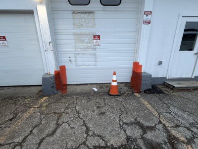

I haven’t moved the lift over yet, but I did consolidate all of my drywall tools and equipment into the new space. Just staging everything so when the lift moves it’s bolt-down, level, and go to work.
While I was measuring things out to make sure my truck could comfortably get in and out of the bay, I noticed something I hadn’t really paid attention to before.
The garage door is 9.5’ x 10’, which sounds huge. And technically the truck already fits through the opening just fine on the winter setup. But my summer setup is 22x14 wheels, and those add enough track width that the truck needs about 103 inches of clearance to comfortably pass between the concrete pedestals that support the columns on each side of the bay.
That’s when I noticed the issue.IMG 04FC7890 CEF9 4976 83DF BB0AE7BFF3AE
This one someone already gave a haircut to. IMG 8365
Those pedestals slope inward about 5 inches at the base before they go vertical. That taper eats up just enough space that the truck would be extremely tight getting through there with the summer wheels.
So I started looking closer at the pedestals themselves trying to figure out what I was dealing with. Mainly I wanted to know if there was rebar inside them before I touched anything.
Looking around the complex I found a couple damaged ones and another one where a chunk had already been knocked off. That made it pretty clear what they were made of.
Solid poured concrete. No rebar. Just massive blocks. Big chunk out of this oneIMG 8385
After digging a little deeper I found out that was actually intentional. These pedestals were built that way to spread the load of the column and also act as impact protection for vehicles moving in and out of the bays. Which makes sense once you learn what the building actually was.
The shop sits on the grounds of Fort Ethan Allen, originally built in the early 1890s as a U.S. cavalry post. Back then the base revolved around horses — cavalry units, stables, wagons, blacksmith shops — everything needed to keep mounted troops operational. But the specific row of buildings my shop sits in came later.
When the Army transitioned from horses to mechanized vehicles in the early 20th century, the outer support areas of the base were converted into motor pools and vehicle maintenance buildings.
Which means the row of garage bays I’m moving into was part of a WWII motor pool.
So the exact bay where my lift will sit likely had soldiers wrenching on military trucks and Jeeps at some point. Kind of cool to think about the timeline of that space:
1890s → cavalry horses and wagons
1940s → soldiers servicing military trucks and Jeeps
2026 → Fully built EcoBoost SHO on a lift carrying the torch!
And since the Army engineers in the 1940s didn’t anticipate a Ford F-150 Raptor on 22x14 wheels needing 103 inches of clearance…:burnout:
Both pedestals are getting a very modest 3-inch Military haircut (high and tight) to straighten that taper out and open the entrance a bit. IMG 8383Once the lift gets installed the SHO will finally have its permanent home base…literally.
Not a bad place to keep the tradition of turning wrenches alive.

I'd box and bolt those piers if you are going to cut into them.

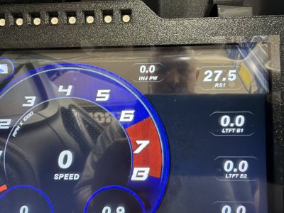

It’s been a long week waiting for David to get back to me. I heard from him today. He said has hasn’t had time to go through the data yet but he plans to this weekend. And run some more tests bc there were a couple he knew for sure didn’t take during his observation of the live tests.
However, chasing my tail with fuel level accuracy is officially over.
I finally wired my fuel sending unit directly into the Tinker dash, and now the dash is reading the sender itself instead of the car pretending it understands a setup it was never built for. IMG 8461IMG 8472IMG 8475Better yet, I dug up the actual documentation for the sender, so this is now based on real specs, not assumptions, not forum memory, and not whatever somebody thinks another Ford used.IMG 8466IMG 8465
My sender is a Fuel Safe / ISSPRO tube-style unit, coated for E85, and the actual curve is 10 ohm empty, 180 ohm full. That is a 10-180 VDO range, not a Ford OEM sender curve. IMG 8476So the dash is now set up for the actual hardware in the car, not some random guess.
That also explains why the stock Taurus gauge was complete ******** with the fuel cell. The OEM cluster was trying to interpret a totally different sender curve and a totally different tank. I basically trained myself to refill early and live in the “don’t be stupid” zone after running it out once, because the stock gauge was never telling the truth anyway.
Setting it up was easy, went into settings and inputs and set the ranges IMG F6065F1B 74C2 40E5 9975 7832E5FA5227Now the Tinker is reading the sender directly and it’s already acting believable. It was sitting around 27.5%, which works out to roughly 3.3 gallons in a 12 gallon cell. It’s stable, it reacts to fuel slosh, and it finally reflects the actual sender that’s actually in the car.IMG 7AB04BA7 3875 49A7 8626 2FE359D43347IMG 8469
I was also able to rename RS1 to GAS, which is way better than looking at some generic input label. IMG 8474Then I set a hard warning limit at 20%. On a 12 gallon cell, that works out to 2.4 gallons left. That is a much smarter cutoff for me because I do not want to screw around with an expensive in-tank fuel pump trying to suck the last bit of fuel out of the cell. I already learned what that sounds like when the car ran out before, and I have no interest in hearing that noise again.
Also popped my cherry pinning a connector, so naturally I’m now ready to wire an ECU from scratch…yeah no. So yeah, this problem is dead. Fuel level is no longer guesswork, no longer OEM gauge fantasy, and no longer me chasing my own tail.

That’s precisely why I never wanted to start running e30 without the ethanol sensor. The fuel gauge is trash. I don’t want my gauge to tell me a calculation of miles to empty under a driving condition, I just want to know how much gas I have. Shouldn’t be so convoluted.

That’s an excellent point. I think I can scale it to 0.0 for min and 12.0 for maximum, then it should simply tell me how many gallons are left. But for now I’ll leave it at % style
