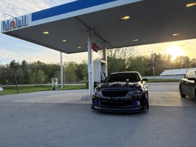

Took the car out for an epic data log. IMG 9729IMG 9726Topped off the 12 gallon fuel cell and drove around. The car is officially trustworthy now. No issues driving all over.
Car shifted clean! 3-4 short shifted a little at 5700rpm, hit 4-5 at 5500rpm. Throttle torque reduction but not as bad from 100-60% with a clean shift. Air Load desired met and air actual spilling over so it appears to maintain load regardless scheduled torque was down. Another clean intervention but a lot less aggressive. Major Step forward!!!!!!!
Drive around for an hour. Trans temp 186 degrees…PERFECT. Snap shot on decel from a peak 114 mph when I stopped the data log IMG 9733
Waiting for Revision 6IMG 9737

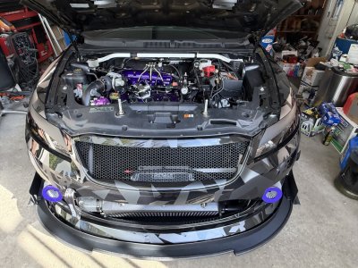

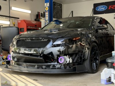

And a random couple pics of how clean this looked after a wash IMG 9718IMG 9720IMG 9721IMG 9723IMG 9724
