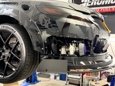

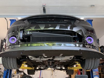

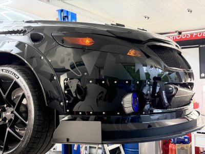

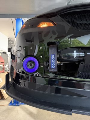

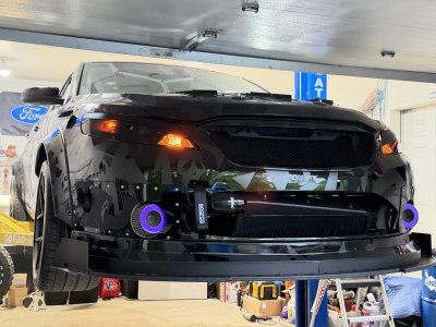

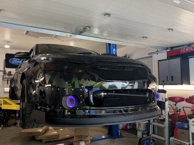

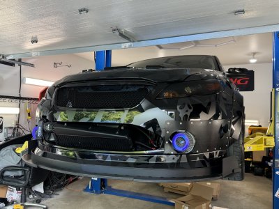

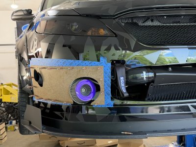

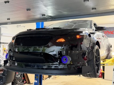

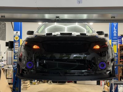

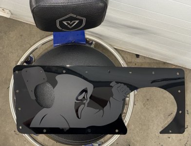

I panel 90% complete. Just need to use solid rivets on the WG dump metal protection plate. IMG 0002
Gloss black PPF. Matte black PPF Ghostface graphic. That’s with flash on so it’s actually more stealth.

I panel 90% complete. Just need to use solid rivets on the WG dump metal protection plate. View attachment 97663
Ok, I have to admit, this is so gnarly I had to log back in just say comment on how rad your latest modification is. You’re building a unique race car with UNLIMITED potential and MAXIUM style that nobody ever in this world will be able to replicate.

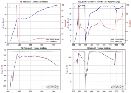

This is interesting to me so here it is:
The Tale of Two Logs: Breaking Down the Torque StrategyIMG 0020
If you look at the data visual I posted, we are comparing the longest Wide Open Throttle (WOT) pull from Revision 5 against the newest one, Revision 6.
To understand Ford's torque-based tuning, you just need to look at two relationships:
1 Top Graphs (Airflow vs. Throttle): The blue line is the physical air the turbos are shoving into the motor (lb/min). The red dashed line is the throttle blade—basically, how much the ECU is actually allowing the engine to breathe.
2 Bottom Graphs (The Torque Brain): The green dashed line is Desired Torque (what the ECU wants). The purple line is Actual Engine Torque (what the ECU calculates the engine is actually making).
Here is exactly what the logs are telling us.
Revision 5 (The Left Side) - The Chokehold
In R5, the car was on a massive leash. The moment I went WOT, the ECU commanded the throttle blade (red line) to instantly drop from 100% down to around 40%, and it held it there the entire pull. Because the throttle was choking the engine, the airflow (blue line) slowly crept up and maxed out at only 36 lb/min. The engine wanted to eat, but the ECU refused to open its mouth.
Revision 6 (The Right Side) - Hitting the Wall
In R6, things changed. Look at the bottom right graph—the purple line (Actual Torque) climbs up and beautifully matches the green line (Desired Torque). Because the torque model is finally happy, the ECU allows the throttle blade to stay open much wider.
With the throttle actually open, the twin G25s finally get to do their job. The airflow (blue line) shoots straight up... and then violently smashes into a mathematical brick wall at exactly 43.23 lb/min. It flatlines completely. Shortly after hitting that wall, the ECU panics, hits the FMEM safety protocol, and violently slams the throttle shut to 17%.
The Logical Conclusion
Until proven otherwise, it looks like every time we remove one software restriction, the hardware immediately runs into the next one. In R5, we were throttle-limited before we could even find the ceiling. In R6, the torque strategy improved, the throttle opened up, the turbos breathed deeper, and we instantly found the next hidden limiter at 43.23 lb/min.
Whether that 43 lb/min wall is a turbo FMEM strategy, an undefined scaling issue, or a hard-coded limiter remains to be determined. But the data isn't lying: the hardware is fully capable, and we are systematically hunting down the software limiters holding it back.
