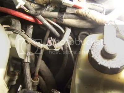

I don't know if this plug wold have anything to do with it, but I can't find what it plugs into. Computer related?
Dasd1jpg1
it's the one right in the center between the EGR plate and the brake fluid res.
