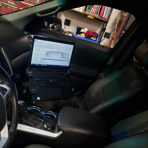

More questions about the livelink sofware:
Is it necessary to have the SCT device connected to both the car and to the computer at the same time? I currently only have a desk top and don't want to drag iit all out to the garage.
I loaded the tune from GH into the Liivelink, and got a screen that looks like sort of like a spread sheet, each line is named, but all the fields were zeros. The name of the tune is shown at the top of the form.
You will need the device and a laptop to datalog your vehicle....at least to do it the right way.

I must be the only HP tuner owner around here LOL. HP OBD2 device can live log without a computer, stores to the device and then plugged into a laptop/computer to be read by the VCM Scanner/ VCM Editor. I originally picked HP - since my car has straight DP's and Gearhead and all others report on their sites they wont tune off-road and gave into buying HP.

You can live log with the livewire and store it on the device too, you do NOT need a laptop, but there are people here that prefer it.
