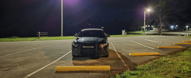

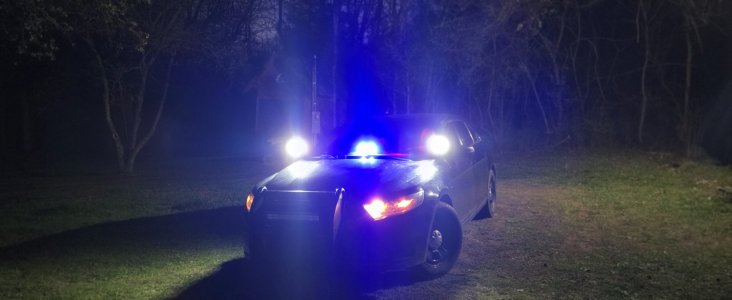

Hey Gang, I have been looking for one of these cars for years and finally found one to my liking with the twin turbo awd setup. The guy I purchased this car from told me to invest in a Livernois tuner, he runs them in his ecoboosts and says they work great. I looked on the site and they sell a package that comes with tuner, air filter, maf sensor, thermostat, and spark plugs for $1300. I called the customer service at Livernois and they said that package with the stage 3 tune should bump the crank hp up to 425-430. Anybody here run these units? Guidance or advice from anybody here with experience would be much appreciated. Here is the Livernois link
