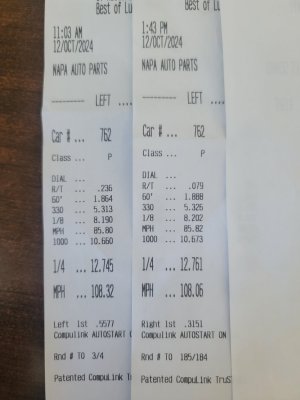

So I've had this question asked a few times with The Mods I have.I went to the track to validate it.
DA was 3200' 2017 non PP with AJP 93 tune, 1 AD trans mount, 3 bar, plugs and K&N drop in. Full weight with spare tire too.20241013 104406

Thanks for the post. @2014RedBull - this has been a constant ask for new folks here - what can i do to make my stock SHO perform better - and how much should I put into it. @76FoMoCo is showing, with a tune and plugs you can get the car to move. The rest is lots of money and harder work to get below 12.5 1/4 mile times.

I went 12.56 @109 with an e30 tune, plugs, 3 bar, and a K&N drop in. Full weight, 1/4 tank of fuel, and front tire pressure at 26 psi.

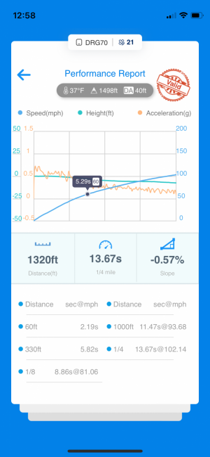

Be happy you pulled a 12.71 not too shabby! I have a 93 tune as well from Ortiz, 3 bar, plugs and thermostat, hot pipes and the AD trans mount. Also have rear sway bar, H&R Springs and PP Struts. Nearly full tank of gas with tires at 36 psi. Granted this is dragy, but probably pretty accurate. Need to get my 60' down quite a bit but just goes to show how the little things add up. Will be spending some money this winter for sure!

Might try a different tuner. Once you have all the supporting mods the tune is not that expensive. Dragy for me is always .05 slower. Given your DA 40' your not far off stock.

What was your front tire pressure set to during that pull? If it was factory recommended PSI, drop it to 27psi(+/- a few). Work on the 60' time. Should be at or around 1.7x - 1.8x, that will you into the low 13's high 12's.

Get the Ortiz tune out of your car.

Tire pressure was 38 and the tires are getting worn out. If we get some dry weather before it snows I will give it another shot
