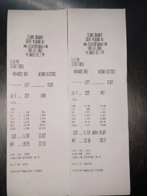

I have basically all the same bolt ones as you, catted pipes stock exhaust though.. I'm tuned by ajp stock turbo's best ET 11.8 at 118 .. With upgrade turbo's 11.77 @122mph full weight on a track..My sixty foot aren't as good with the upgrade turbo's.. Are They worth the price? I picked up a tenth and 4 mph it pulls like a freight train..

Were both times on the track? My times were on the Dragy. One tenth and 4mph for $3k worth it to you?

I only do full runs on the track.. I'm sure I can get more out of it but it's a conservative tune. I thought it was worth it. It sounds awesome and runs real good..

I’m not questioning whether the upgraded turbos are great units, just trying to understand how spending $3K upgrading turbos only seem to net a .1 and 4mph increase over the stock units?

1.77 60 isn’t bad with 11 second quarters. I’m assuming you weren’t on a tire. My best 60 was 1.6 but that was in the high 12’s. After I hit low 12’s and the eventual 11, traction returned as an issue and never saw another 1.6xx
All my passes were on Conti DWS at 28’ish pounds.

Fair point, but you also can’t look at it as $3k, only the price over stock.

Ok… How should I look at it? I’m looking for bang for the buck. I know at some point upgrades cost more, but I’m looking at the turbo comparison. Thanks!

You have to look at in a different light. The stock units (while good) get everything out of the gate and fall off at the top. Usually they don't make enough power to give you bad traction issues. The bigger units do everything better. They make more power sooner (thus creating traction issues), they make more across the board, and they don't fall off on the big end. 3k for another 60 to 80 hp wheel increase, which transforms the car.........
That is a bargain.
