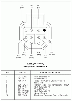

• Connect ohmmeter negative lead to TCC jack and positive lead to VPWR jack on tester.
• This is to test TCC.
• Record resistance. Resistance should be between 0.98-1.6 ohms.
Connect ohm meter between the transmission body and pin three.
C168 transaxle

michigan
C168 transaxle
ok i will do this
