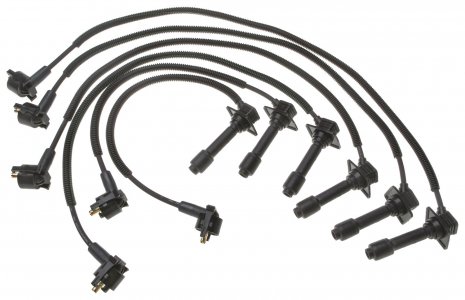

Well got plug wires, intake gaskets and valve cover gaskets coming monday. Spent 130ish dollars total, not bad imo. Got the gaskets on rockauto for 58, and ACDelco 9466A Professional wires on amazon for 73. Should run much better after this tuneup :)71  11i2BbkL SL1500
