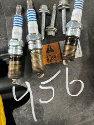

Below you will find the results of an impromptu plug change after purchasing my car a few weeks ago. So far I changed the front three earlier but will be getting the back three in a little bit. I assumed 4,5,and number 6 cylinders are the front three so don’t **** me if I’m wrong lol. Noticed a decent amount of oil on two of the three. Talking with my brother we are thinking valves stem/seat issue. I don’t know that much about these engines yet to fully diagnose but I’m hoping someone that has gone through a couple of these higher mileage engines could chime in (109k). I guess my first question is should I be worried? Second is this something that can be taken care of at the time if I decide to do a timing chain? Or do I buy a new crate motor for the 6k. Or just run it till she pops then replace motor and PTU at that time?

I’m assuming the most that will really come at this point will be oil consumption.

doesn't look too bad to me. may just need new valve cover gasket and plug well seals.
