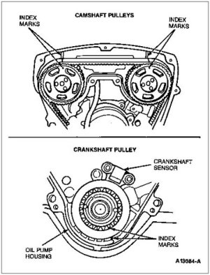

So what would cause it to be out of time? I triple checked the timing marks on all three sprockets, and yes, I did pull the balancer and check the actual inner sprocket marks just incase the balancer has sifted (it has not). I havn't messed with the CKS during this, and the CPS can only go on one way. Still had a DIS tester at work and it passed multiple times.

To me it sounds like you have the timing off. I would remove the crank damper and pull the upper and lower timing covers and verify the the belt is installed correctly(lettering upside down when read from the passenger side) and that the timing marks on cams and crank line up properly. I would remove the belt and start fresh. Post back what you find.

Yup, all the timing marks still align. And yes, paid extra etra super atention when putting the cams in, aligning the dots with the light colored chain links. I would call the sensor vane more left than lower. Is it even possible to put that on wrong? Arn't the screw holes slightly offset?

You want to pull the timing covers and verify the crank and cam sprockets are timed together like they should be. I would have done this weeks ago.

Yes, 1 mark each for the cam sprokets, and two separate marks for 3.0L and 3.2L at the crank. Bottom of text towards the engine, aka upside down if you're leaning over the right fender.
