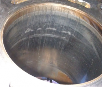

Front half: Material usually gets sucked back into the engine, scoring the cylinder walls beyond repair. Use a bore scope to see if you can see vertical scratches on the walls. If the scratches are faint and at an angle, that's the normal factory cross hatching:
1701750927668

Well, my Harbor Freight bore scope is pretty much useless. I can really only see the tops of the pistons and its super dark and grainy. I wonder if I can rent such a thing.
As for the cat, It's a replacement put on by the previous owner, so if such a thing had happened before that, I wouldn't know.
Update: tried the horoscope again and got this1208231023a
Is this bad?
Also did a leakdown test thru the dipstick and it held no pressure at all. I could hear air near that cylinder but wasn't sure if it was a weird internal pcv or something

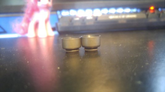

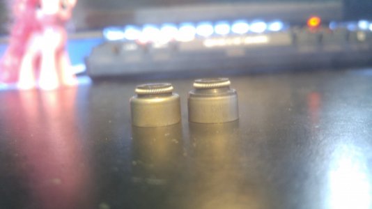

Anypony here install Viton valve stem seals? SHO source website says intake and exhaust oughta be the same, yet the set I got has two different ones. I emailed him, no answer yet. Afraid of popping the old ones out to compare incase they just fall apart. That, and I don't understand how they can be the same if the stock ones are different for in and ex.
I do know that the intake and exhaust seals are of a different color as SHO Source says, but don't think there are any other differences. Haven't used the Vitons which are supposed to be superior according to SHO Source.

One is just a little taller than the other. Got a chance to peruse RA between customers (literally the only time my brain can focus for some reason). It looks like the taller one with the rubber extending onto the shoulder (the one to the right in my photo) is the intake.
