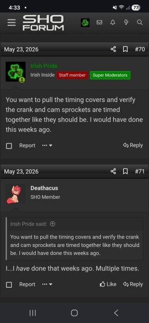

After getting this all sorted out and the car is now running again I want to come back to this.
Screenshot 20260608 163307 Chrome
If you did indeed pull the timing covers and verify that the crank and cam sprockets were timed correctly multiple times how did you miss the fact that the crank sprocket destroyed itself and the crank sensor? This car should have been running weeks ago and not put back together in the parking lot at Carlisle.

Y'know, i'm not really sure. Guess I just didn't think to look that closely at the sensor, both screws were there and the carnage wasn't really obvious until I pulled the sensor off. I did look to see if there was any debris dropped down there, like maybe one of my lost valve spring keepers. Rookie mistake I guess.
