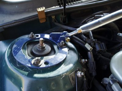

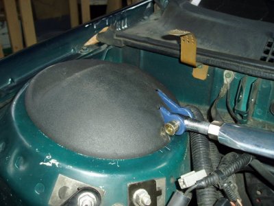

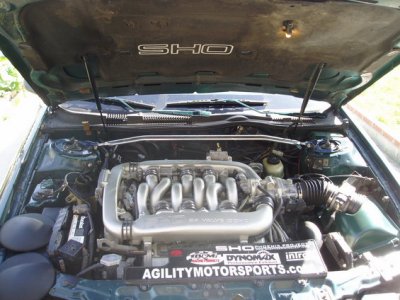

Matt where are you getting this info?? The Neon bars are very stiff, and a million times better the old aluminum SHOShop bars that you can bend with the push of a finger. Only downside with the neon bars is the mounting plate.
P1010032
P1010033
P1010036

Yep, you can use the bottom bolt hole on mounting plate, you have to re-drill the other two tho...if that makes since...Just look at Matt's pictures in post 7
