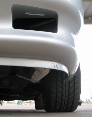

Mine go from the fog lamps and just blow in the general direction of the caliper. Like this:
Duct front
WDuct
It's not too hard to remove the fog lamps and replace them after the event.
Duct front
WDuct
Somedude's turbo SHO has a bit of stuff in the way of that:
plus the filter -to-turbo pipe, which consists of a diesel K&N on the drivers side, a pipe all the way across the bottom of the bumper , an elbow up at the PS fog, and an elbow into the front of the turbo ....
i kind of have turbo plumbing in the way covering both of my fog light opening completely. the only way for me to get brakeducts will have to be from the corner lights.
