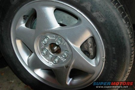

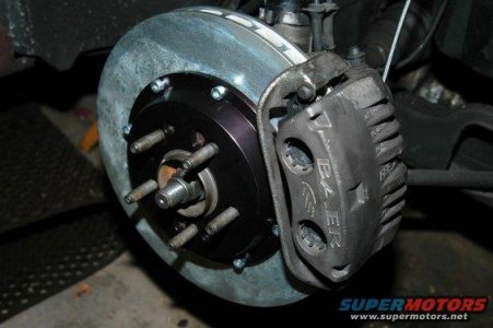

My custom 12.5" TCE/Baer Racing set up fits under slicers with some grinding on the caliper. Keep in mind that the Bear Racing set up uses corvette rotors that sit further towards the hub than the standard Cobra setup. This deeper offset allows clearence for the slicers and also puts the unsprung weigh inboard for better handling. I think I have the best of both worlds with the lightwieght of the Wilwood set up with the more maintanance friendly floating PBR calipers.
I made 4 back to back stops from 100mph to 40mph while I was bedding the FPCM Z rated pads. I experienced no fade.

12.5" corvette/baers here... the slicers rub ever so slightly on the inner part of the wheels, but a few passes down the 1/4 with my drag radials remedied that :nut: This is one **** of a setup, and with bias plugs on my stock vented rears I can slow down in a hurry. When I autocrossed for the first time people were commenting on how well my car braked and didn't break loose with the kumho mxs. Most of my times sucked, but that was operator caused :evilgrin:
Good luck with the choosing... I should add though the corvette rotors are HEAVY.

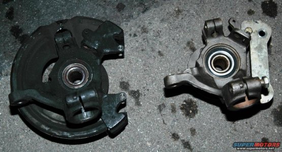

Hmmmm. I think that's the route I will be going. What is the difference with the mounting brackets for the calipers between the baer 12.5 kit and the cobra set-up? I imagine they are thicker where it meets the knuckle moving them inward? Any idea how much inward?

The knuckles were already machined by Baer Racing. Alot of material was removed from the knuckles.
Original knuckles with dust shield on the left. The modified knuckles without dust shield on the left

wow, looks like a good bit of weight was taken off the knuckles themselves, that should help offset the weight of the larger brakes
i know its not something you would feel while driving, but still ...
With this brake setup, my lightweight wheels and tires, I have 10lbs less unsprung weight on each side in the front. I also have 3lbs less rotating mass on each side, (4lbs less for wheel/tire, plus 1lbs for the rotor) too. The lower rotating mass will help with the acceleration and the lower unsprung weight will help with the handling. I figured I did well in greatly increasing braking power without adding any extra weight or rotating mass, although this set up was expensive.

wow, better weight savings then i expected !
now just find aluminium knuckles that can be modified to fit on the car, lol
