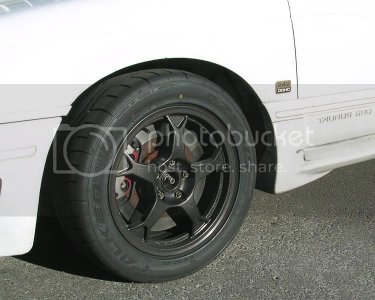

I am running 16x7 Team Dynamics Pro Race 2's with 13" Cobras and they definitely clear the rim. The wheels themselves are very light at 15.x lbs. I got them from Shonut.

How do you like those falkens?

SASHO91 said:
They are FREAKIN' AWESOME!!!!!!!!!!!
I won't be autocrossing them until the season resumes in January, but so far the grip is phenomenal in the dry. Pretty good in the wet. Very stiff sidewalls makes the steering ULTRA-responsive. It is very easy to see why they have a reputation for being the #1 street-class autocross tire. Definitely give them a try.
They blow away the Goodyear Eagle F1 GS-D3's I used to run on the street.

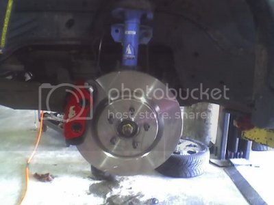

This setup fits just fine under 17" wheels.
Photo 090205 005
Photo 090205 007
Yeah, yeah, the wheels look like ass, but they are not mine.
Whole setup including 13" slotted rotors, OE Cobra pads, stainless lines sells for $699. This setup will definately do a great job. For track use, I'd recommend a set of track pads. This adds $150. I've got this setup on my race car and coming down the hill into 10a at Road Atlanta, I go from 140mph to about 55mph in 250'.
