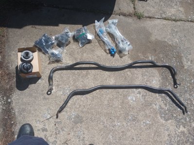

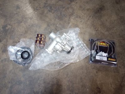

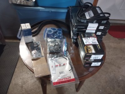

Fast forward to today, I've gained quite a lot of knowledge on how to do most of what I'm trying to do though it's a bit intimidating doing most of this work on my own. Most of the parts I believe I need to at least have a mechanically solid SHO have arrived and I'll be ordering a bit more tonight. So far I've gotten 24/26mm sway bars with poly bushings, new end links front and rear also with poly bushings. 3rd gen rear subframe bushings, poly front and rear tension strut rod bushings, stainless steel brake lines along with new pads and rotors. As far as engine maintenance goes, I've gotten an intake gasket and coupler set, new drive belts, a new timing belt, new water pump, CPS and front main seal. I also got new rod bearings but these came from rock auto so I wasn't sure if these were correct or not. I ordered new spark plugs as well since I had to drive for a couple months with the MAF sensor issue. Tonight I plan on ordering the valve adjustment kit, brake bias plugs and I have a feeling I'm gonna need way more poly grease than I currently have. I'm doing my best but I am disorganized as fork so if there's anything else I should get before I really get started on this project I would greatly appreciate the advice. Also I'm a bit lost as to what order I need to do this stuff in, the Chilton repair manual I have helps, but as I'm sure many of you know has it's limitations.

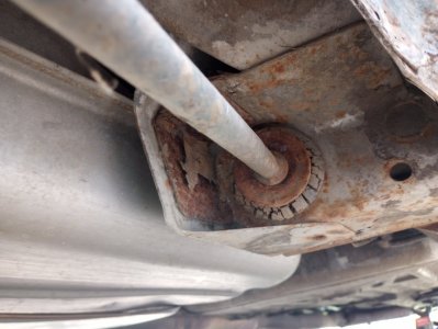

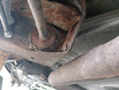

Left and right rear tension strut rod bushings, looks like they're the original ones. These were by far the worst but the others were all showing various levels of dry rot.

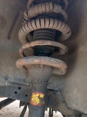

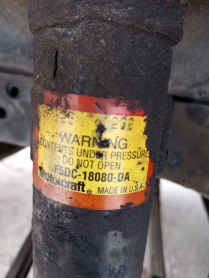

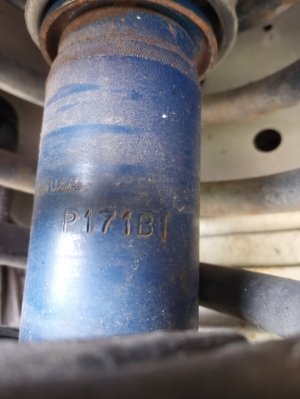

I'd like to also replace these springs and struts with something better but I have a feeling I'll just have to piece something together. I got some pics with the part numbers for reference.
Here's the left and right rear, looks significantly more worn out than the front.

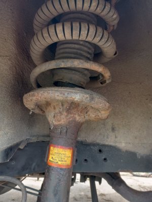

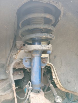

Here's the front left and right, these two look relatively new.

welcome. u didn't mention the mileage and from the pics it seems to be many 'salty' miles but u can correct most of that. those front struts appear to be oem ford. struts of any kind will only give u about 100k but u are on the right track and all of these guys here will help for sure.
