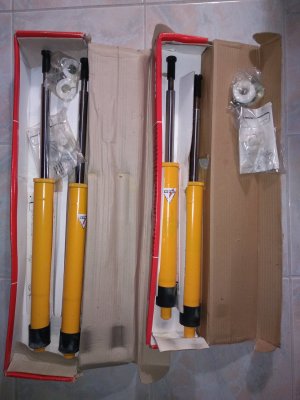

If someone is wondering, they look like this:
IMG 20210420 195658032
This is a set I bought in 1994 when they were first introduced. I never got a chance to install them; sold them last year. They were discontinued about 2 decades ago, so good luck finding any more.
The part numbers are 8641-1268S and 8641-1269S. I don't recall which part number corresponds to the front pair or the rear pair. Since they were a "cut the strut" installation, there isn't a compatible set for another model (at least not that Koni will identify).

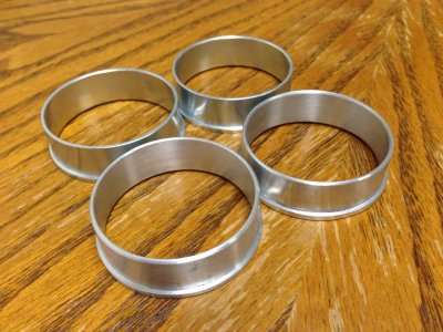

The Gen1 and 2 rears are interchangeable meaning Gen2s will mount on a Gen1 and vise versa. The difference being that Gen2 stock struts are shorter than Gen1s and if used as housings for Konis you need the proper length Konis to fit the housings.
Some replacement struts did end up being stighly too large to fit the Konis properly. That's why Koni included these aluminum spacer rings in rear kits. When you installed your rear Konis into the housings they either fit very snug or just a little loose. If they were loose then you used the spacer rings. I've never had a set require them so that's why I still have these.

I needed those spacers on a rear set I have. Shosource had an extra set that I was able to get
