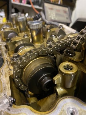

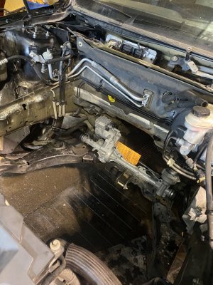

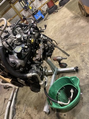

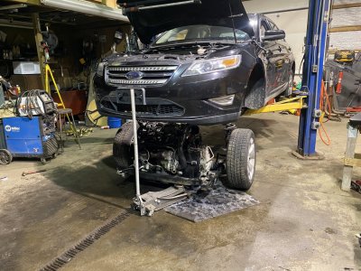

Been really inactive recently tbh was giving up on the car but I’m all in now dropped the subframe today with engine and trans will be posting more often for feedback from you guys as of now the engine is getting a timing kit new valve cover gaskets turbo lines and possibly down pipes trans is getting full rebuild1E25A983 6A10 481E AB07 7C5E21AEB0B6

Been really inactive recently tbh was giving up on the car but I’m all in now dropped the subframe today with engine and trans will be posting more often for feedback from you guys as of now the engine is getting a timing kit new valve cover gaskets turbo lines and possibly down pipes trans is getting full rebuildView attachment 83773
Sweet! Going to be a fun(and expensive) build!

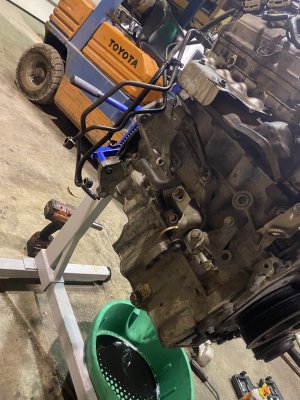

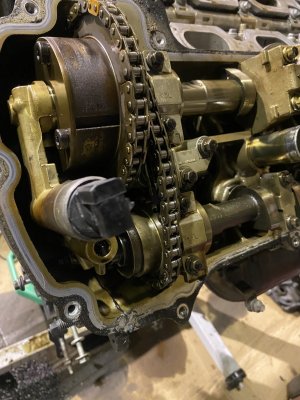

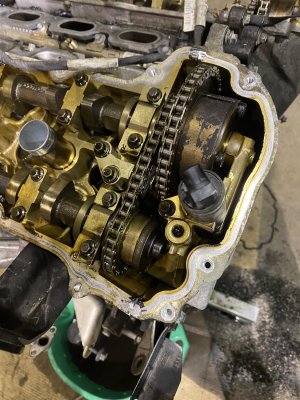

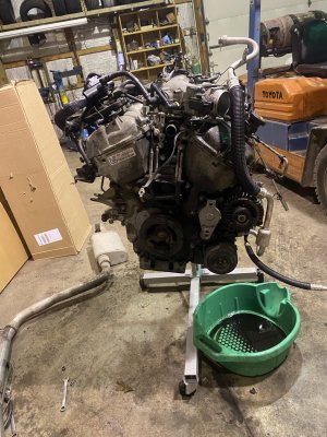

Transmission is being rebuilt hopefully with raybestos clutches if I can find them not sure whats all happening to the engine for sure getting a timing kit and new head gaskets and thinking about getting turbo cores from 5 star tuning getting all the exhaust and down pipes cerakoted to hold heat it aswell as the intake manifold to keep it out

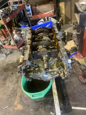

Guess it was a good time for an engine refresh caught her just in time
