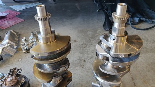

Negative ghost rider. I just did mine. I have a 2015. There has been another update. They now have a roller chain which incorporates wider gears. Trust me, I know because they thought they had everything they needed, but the crank gear was not the right one. I was down for another week. Thank God it wasn't back ordered! Can you imagine? lol Water pump and timing set job ran me $3000.
Did you do the work yourself? Picture below is the different crank gears which is a different spacing in the 15+ years because the crank shaft snout is different, however it's the exact same as the other years with no fitment differences on the chains. When I built my engine there was no difference between 2013 and 2019 parts other than possibly updated part numbers. Everything was identical and could be fit between those years back and forth.
