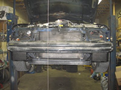

Id drop Josh a line.
IIRC, he mentioned a setup he ran before the ice-chest-in-the-trunk setup.
It was a setup (air/water) that involved two small "radiators" that fit down near the fog lamps. I remember him saying it worked quite well, just not enough for the boost he was running, and prolonged track usage.

:thumb: I like that idea.. since I have no foglights anymore. Thanks Kenny
No problem. :thumb: Im still trying to remember what kind of radiators he used.... im thinking it was some king of OEM (used) setup modified from another vehicle, but cannot remember much.
