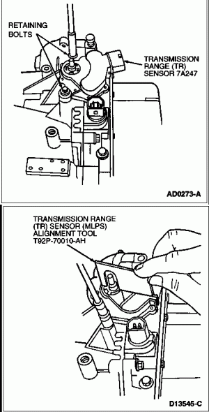

The gear indicator in the cabin isn't important, but making sure the TRS is properly sdjusted is. The TRS is the black sensor located on the gearshift stud on the tranny. Put the car in Neutral, pull the gearshift cable off and adjust the sensor so that the lines on the center ring and the main housing of the sensor line up.

Do you happen to have a diagram of what points I have to make sure are aligned?
And if these are off, will this cause the harsh shift?

I can't help with the alignment but I doubt it would cause the shift issue.
The speed sensor that plugs into the tranny will however cause severe shifting...confirm that it is plugged in.

I think the TRS is real close to being aligned, because I can only start the car car in neutral or park.

Probably not. The easiest way to see if the TRS is off is by the backup lights. If you pop it into reverse and the lights come on without any giggling of the shifter it is on the mark.

The range sensor should not affect shift quaility unless it is bad. Chances are, if it starts in park and neutral it is on correctly. You have to check its function with a scan tool, or a volt meter. I only know how to do it with a scan tool.
