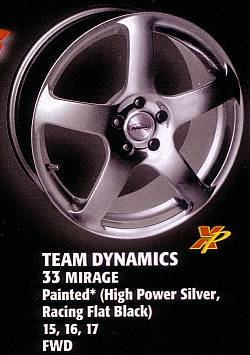

Nice Rims. What brand, model, size and how much do they weigh? The idle needs to be raised otherwise you would be on the verge of stalling all the time with the race cams. Dont know about the supercharger.

thanks,i gotten a year ago so i forgot who make them but, ill check as soon as i get a brake from work and ill tell you later,they are 18"with the tires they weight the same as the 16" slicers with tires, i put them on a scale one time because to me they were looking a big to heavy but i turns out they about the same i forgot exactly what the number was

18" SPORTS MAX

92sho16 said:
TeamDynamics Mirage
These look like the same wheel.
yeah they look almost the same, by the way the iddle problem i had was fix a while ago i have to installd a after market fuel pressure regulator, thanks.
