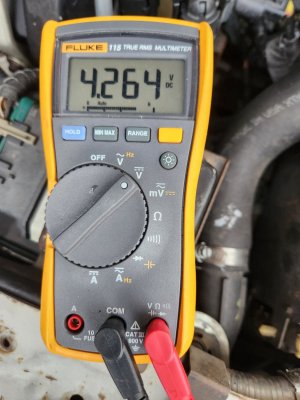

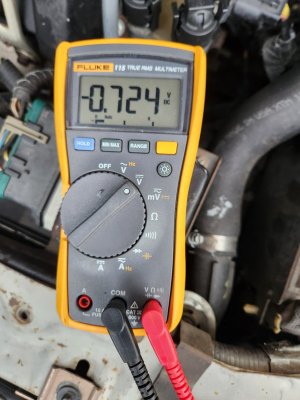

Check voltage at the TPS. Your throttle body might need adjusting.

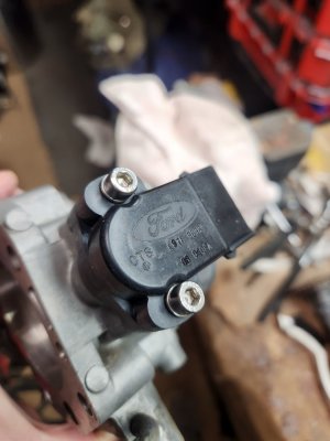

Picked up a replacement TPS but the bottom screw stripped out. Mike sold me a replacement TB and screws so I can just swap in the new TPS and extract the old one on my own time.

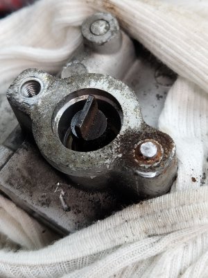

Went to take a hack at getting the screw out so I can clean it up and have a spare. Vise gripped the shaft and it just sheared right off. Glad I got the spare TB before I did that! This one is junk now.
Grind that one flush and then use a LH drill bit to get it out.

The middle wire on the connector is the signal wire. It looks like you measured it correctly. This diagram is actually for a Foxbody TPS but its pretty much the same thing other than the starting voltage for the SHO should be between .9 and .99. You might try adjusting your throttle plate a little to see if that helps your idle.

Based on the voltage numbers you posted I would say you need to adjust the throttle body. Fully closed you should get voltage of .9 to .99 at the TPS.
