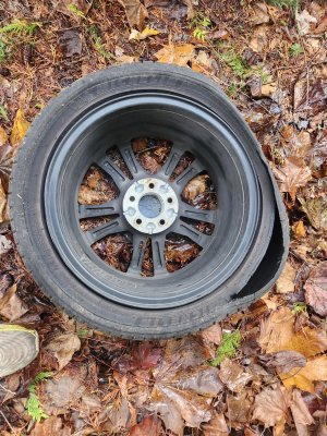

did the rim survive? Driving to work this morning, I hit probably a tire scrap that put a wire in my tire and tore my side skirts (at least I wasn't driving the SHO)

Yeah, just scuffed. Tire rack is trying to get my to submit a road hazard warranty but I'm pretty sure I didn't hit anything, and the sidewall just blew out.

With aftermarket and hard to find rims--try to get an extra for stuff like this. Otherwise you end up getting a whole new set if one gets f'd

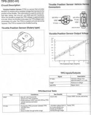

Check voltage at the TPS. Your throttle body might need adjusting.

Unfortunately my relatively new tire lost all pressure on the highway today and possibly trashed my rim, so I have to pull that off and see what happened.

The middle wire on the connector is the signal wire. It looks like you measured it correctly. This diagram is actually for a Foxbody TPS but its pretty much the same thing other than the starting voltage for the SHO should be between .9 and .99. You might try adjusting your throttle plate a little to see if that helps your idle.

Thanks @Irish Pride I'm starting to think I got a bum idle air bypass valve. If the TPS isn't malfunctioning, I can't really think what else would be causing this behavior at idle.

Based on the voltage numbers you posted I would say you need to adjust the throttle body. Fully closed you should get voltage of .9 to .99 at the TPS.
