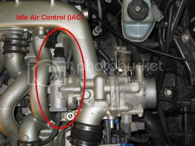

I want to clean it to see if my idle will go down to normal. It sits around 1200+ all the time
Where the heck is it? I read in a thread that it looks like a roll of quarters but I found nothing like that other than the curly spring for the throttle cable

That's supposed to look liek a roll of quarters? >_>
Thanks!
Now off to fiddle with it til it comes out and try to clean it with some spray carb cleaner

It kind of looks like a roll of quarters. haha
Have fun! Hopefully that solves the idling problem!

Don't pull it out if you haven't tried to reset the idle yet. You can do more harm than good.
HERE is the idle reset procedure.

I suppose it's tried to reset its idle when the battery was drained and killed by the stupid crap amp that was hooked up in the back that didn't do anything a while back.
It's been like this for over 3000 miles.
I got it and poked the springy thing inside. It looked pretty clean and it moves around freely and easily.
While I was fiddling around under there I noticed the throttle cable adjustment screw threaded rod thing seems to have been turned.
I moved it a bit and it idles nicely! at about 800-900 wow what a difference for driving about.
I made it show 5 threads on the engine side

dont try to take it off with out pulling the intake. i did it with out pulling the intake and it was not fun at all it was a major pita. I have a few extra if you end up needing one just give me a call

^ could you count how many threads are showing on the throttle cable adjustment screw/threaded rod thing on the engine side?
I think my IAC works. It idles cold at like 1500or so and drops down to 1100-1200
and I did try to take it off without taking the intake.. the bottom screw was :madflame:
