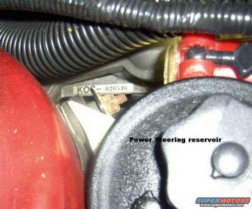

You can see if the serial number is still on the back head and get an idea maybe of if it is original.
This number here is from my '97 made in late '96.
V8 engine serial number
