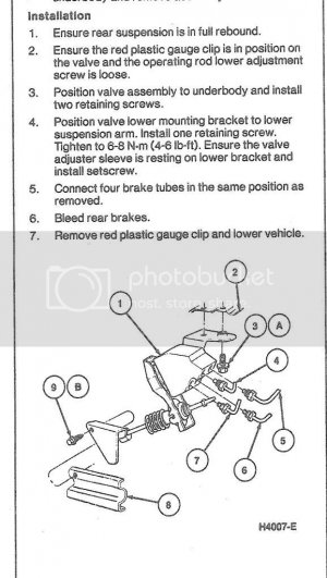

Valve
The little red clip it speaks of basically just spaces out the nut on the rod closest to the brake lines (pictured) approx. 1/4" from bottoming out.
