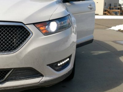

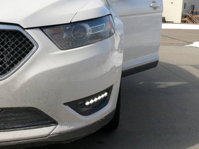

I have the Drive Brights also, so when the car is in normal mode, lights in Auto and it's day time, the turn signals and the Drive Bright DRLs are amber? And when you use turn signals.... they both obviously flash amber? You got pics?
Parking lights only...then DRLs...then lights on. I have a video that I may figure out how to post but basically when turn signal is on both the drive brights and turn signals blink amber. When headlights are on turn signals work normally and drive brights switch back to white after Amber turns...99b1b99ae309e89c7c333cfc7ec44c2cC5e4840396381284860de3815835f66f1f81fe1b4ea77658f110cb58f0b1d54e

OK, you're confusing me! Your pics show how the Daytime Bright DRLs work normally - nothing is different here. This is exactly how mine work out of the box. So what did you modify in FORScan?
The middle picture is the DRL where both are amber. My drive brights were white when they were on before the Forscan mod. In the first pic where they are on by themselves and white is parking lights.

Ah Sh*t! OK, I follow now - sorry! I thought middle pic was while turn signals were activated. Very cool!!!
