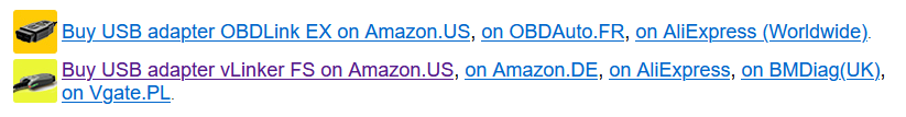

You don't say which USB adapter you have. The FORScan recommended adapters will read all modules. Personally, I like and use the vLinker FS with my laptop and the vLinker FD with Android. BT is fine for reading and clearing DTCs. You won't have trouble programming with BT until you do and then you have to figure out what you screwed up. FORScan recommends a wired USB connection for programming.

Notice only USB adapters are listed under Windows.
What USB adapter are you trying to use?
I noticed all that. The application said it only works via USB, and had a suggestion for purchase.
The suggested USB cable is the one that only connected at the lower speed. On a lark, I tried using my laptop's BT. That is when I learned Forscan actually works via BT.

I now notice there is a different "suggested" USB cable to use:
1724984314598
Of course, it is a bit more expensive.
Keep the one I have, or buy the second one to see if it connects at a faster bit rate?

The first adapter you have is a knock off using FORScan's name as a marketing ploy. There are only two recommended USB adapters and they are listed on FORScan's website. The vLinker FS is my choice and sells for $30-35 on Amazon.
1725030669516
