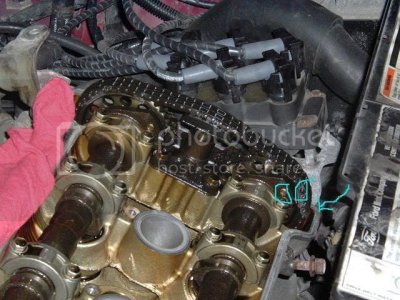

Look at the timing chains sprockets that are attached to the cams themselves. You will notice that these sprockets are attached by 2 10mm bolts that are exactly 180 degrees apart from each other. Now look at the cam chains. The chains will have 2 links that are different from the rest (cant remember if they are darker or what... its been a while since I have seen them in person). These "different" links should be centered on those 2 10mm bolts. To make sure the cams are in time with each other, those 10mm bolts should be aligned with the surface of the head where the valve cover seals to the heads. Here is a picture to help show what I am talking about here as I am sure I have lost you I circled the 2 10mm bolts that need to be aligned with those chain links. The arrow points to where those bolts should be resting at. Again, those bolts need to be parallel to the top of the surface of the head. Maybe someone will have a better picture for you. I lost a ton of helpful SHO pictures so this is as best as I can do.
Step12f Pic was taken from www.shophoenixproject.com and modified by me.

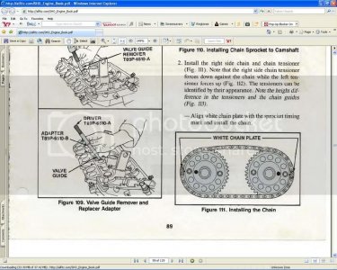

EDIT: Here's a few more pictures that will really make things clear for ya. Don't ask how I got ahold of this little book ;)
Here's how your cam chains should look when they are aligned.

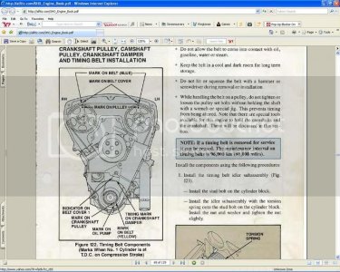

And a diagram straight out of the Ford Taurus SHO mechanics manual of where all of the timing marks are located for the timing belt.
Timing3
