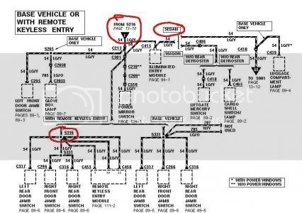

Long story short, the cigar lighter got short circuited and now the underhood light, glovebox light, cigar lighter and both map lights have no power. The I/P fuses are all good as are the C/B's. Any ideas?

Im sorry.... Thats going to be hard to find. Is there any power going though the relay/fuse?

Have fun hunting for melted wires! What gets me is the wire melted before the fuse blew... you sure it was a 15 amp fuse in there?

Yeah the correct fuses are where they need to be. Unfortunately I don't know where the connectors or splices are for that circuit.

Just to mention my sho does not have RKE and the courtesy lights work when you open the door or switch on the dimmer switch. The overhead map lights, visor lights, cigar lighter, underhood light, and glove box light have no power. When I test the cigar lighter + wire with a meter it read ~8 volts. Thanks for the diagram anyways. :)
