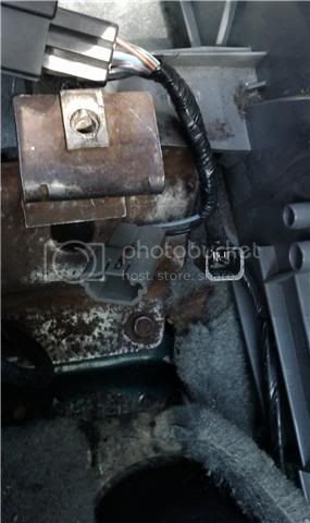

Does anyone know what these plugs are for???

I have a 95 MTX. I pulled the center console and found these 2 plugs hanging out under there and I don't see anything that they might plug into. Anyone know or have any ideas? :shrug:

OD switch and Shifter assembly light plug. Obviously since you don't have an ATX, those plugs are not used.
Nothing to worry about.

Right but the body is still the same as a GEN II GL etc. Doesn't that mean the interior wiring would be the same?

They didn't install/need those plugs in 92, it wasn't part of the wirering harness yet, body generation means nothing.

I don't have the OD off plug, but I definitely have an illumination harness under my center console.
