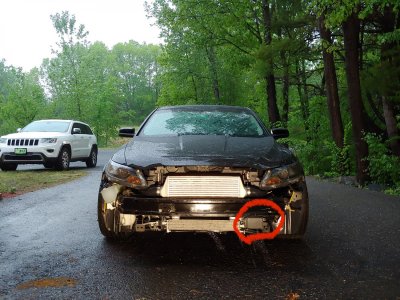

You should be able to get to it easily after removing the front bumper. It’s bolted to the reinforcement bar, you just need to remove the bracket and disconnect the wiring harness.

Ok seriously it's a bit of effort but it's not that difficult. Don't forget to unplug the lights and reconnect when you reinstall it. The toughest part are the clips in the wheel well that tend to need replacement. It's a little flimsy when disconnected and may be easier with a second set of hands
