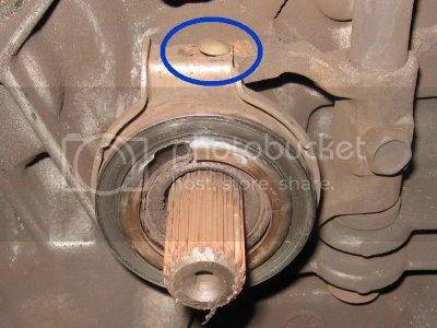

The ceramic TOB from shonutperformance includes a new pin with it. :thumb:
There is just one, on the top. It's a plastic push in pin. You need it.
TOBpin
That's a pretty fugly TOB you got there. Did you do that customization yourself? ;)
Small wire-like cotter pin FTW, in my case...and my ceramic TOB did not come with that thing...
Josh usually tapes it to the box. I nearly missed one that way, too.
BTW, safety wire works really well, too.
