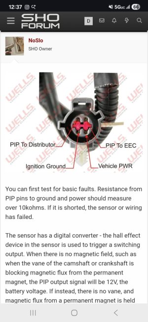

Well everyone that had helped thanks alot guys but i found a way to test out the crank sensor and its not testing out so well
And you can test it by plugging a multimeter into the prongs and testing for kohms anything over 10kohms and the sensor or wiring has failed and low and behold it failed10000498691000049873
And you can test it by plugging a multimeter into the prongs and testing for kohms anything over 10kohms and the sensor or wiring has failed and low and behold it failedView attachment 97085View attachment 97086
That link says resistance SHOULD measure over 10 ohms.
