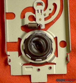

It should not be skipping unless you hit a large bump or something.
Mine got to the point it skipped so much I could not listen to a CD. Took the CD player apart and there was 4 gel filled isolator mounts that had all sprung a leak. Got some new ones from a list member who had destroyed his CD player for some reason and it's worked like new ever since.
Bad mount
BTW to change the CD player to a horizontal one you need to move the spring loaded lever so it points to the right.

Hmmmm..... maybe i have my front two isolators leaking. that would explain why braking makes it act up. from the weight being transfered forward. ill take a look at it.
