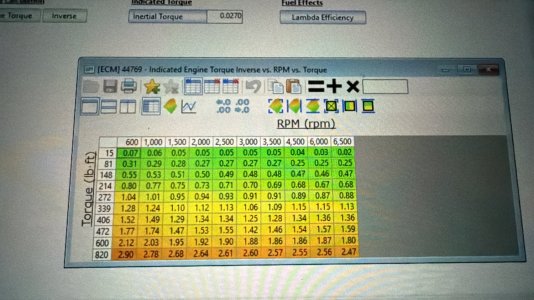

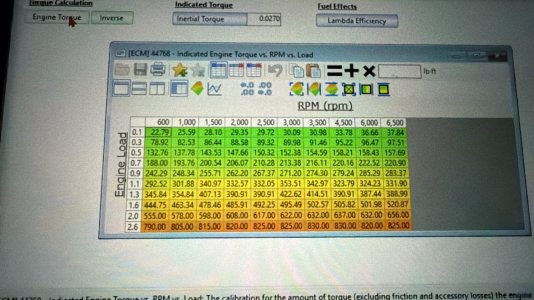

Limits: Missing Engine brake torque was added to torque management. Allowing the OEM 369 lb.ft limit (500nm) to be visible and editable to 5,000 nm.
The next limit is the Indicated engine torque and indicated engine torque inverse tables. Previously couldn’t scale above 2.0 load. It’ll be scalable to 5.0 load later today, next Beta release.
Load is essentially airflow the motor can make. Think of 1.0 load as 100% airflow. 2.0 load is double the normal air mass entering the cylinders. My car reached 1.922 load, which means it was operating at nearly twice the airflow of naturally aspirated state. Ford set the max limit to 2.0 thinking nobody would ever need more. Once you exceed that modeled range, the PCM switched torque sources and identified the next bottleneck in the torque model, the model itself
Which will now be adjustable

I’m working mostly with David Siebert II right now and we are working on the torque model pretty heavily.
We’ve basically separated capacity from demand. Which is likely what every successful tuner does…..so this isn’t something we’re starting it’s more of saying….we found this state on our own.
What I kept seeing in my observations while using the compare file function is the massive headroom the OEM calibration gives the car. It’s already setup for massive capacity VS what it’s demanding.
OEM indicated torque hits a load axis of 1.9 and 500+ torque. Meanwhile it’s capped at 369 engine brake torque….and many other factors but do you see how much leg room the ECU has? It’s mathematically plotted and expanded so essentially there’s no point where the ECU doesn’t know what to do. My assumption ….its an assumption….but my assumption is I bet that torque model doesn’t change when ppl start doing a tune. More boost and more power and it can operate within that massive headroom setup by Ford engineers. So it requires no edit up until a certain power level. Not saying nothing gets edited but I have a feeling that generous torque model can hangout unedited for a while.
It seemed like my car kept hitting the edge of the model. 1.9 hit it. 2.2…hit it. Then I realized that’s not how you do it. You don’t try to edit the torque model for what demand you want today. It’ll always be a battle or hitting the fence and unnecessary interventions. So looking back at the OEM model with a 1.9 load ceiling it all clicked.
We expanded the torque model to 2.6 to give us capacity. And we didn’t add rows. David went into excel and mapped our new torque and inverse tables completely keeping the original 10 rows. He rescaled driver demand and OSS. We now have mathematically given the ECU OEM like capacity for the new hardware. There isn’t a point where it isn’t in complete control.
What I mentioned before about tuning for today. What do we want to tune for today’s goal? We don’t want to tune it to capacity….that’s why that’s been expanded. We want to tune demand for today. Demand operates within the capacity and the ECU has no blind spots.
We are still learning how the G25’s behave relative to WGDC, so the demand gets hard capped. We want to command a pressure limit of 69.22 inHG which is 34 psi absolute. Minis BARO 14.7 psi it’ll put the turbos at 18-19 psi boost. WGDC% is set to .25 and we also gave the turbo a failure limit of 60 lb.min so if it behaves differently than we expect the PCM will drop spark and the throttle. So we have tuned our demand within the capacity with a fence. And spark hard capped at 16.
Then load can fall where it falls. 2.0? ECU says no problem. 2.1? ECU says sure. 2.34? ECU says yup and? It says we got 2.6 load here.
But it’s hard capped to 16 spark and 60 lb/min. 60 gives it some wiggle room bc if we set turbo failure to 58 lb/min that’s right on the edge of 18 psi. We don’t want to clip it.
Just think about it. If you can do a back flip within 6’ you wouldn’t do a back flip in a 6x6 enclosed space. You need room. What does everyone do? Back up and give you room. Give you space. The ECU calibration is no different. Scale the capacity for the new hardware and then demand your back flip so it has room to land it

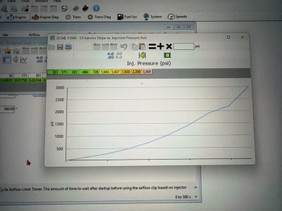

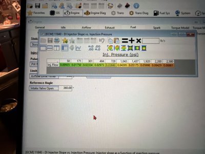

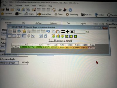

It happened. I popped my tuning cherry. Lmfao. But seriously I edited my own tune and I’m just waiting to hear from Mike @ XDI before flashing. That’s only a small part. I’ve been influencing David and also learning from David and that dynamic is working really well. I’ve now made some edits to OSS modifier and our Driver Demand tables I can’t wait to try.
So on the XDI side of things I’ve been just using 2150psi rail pressure (stock value) this whole F time…….my 8k fuel system? Just doing stock stuff, well except the XDI2000cc injectors doing their thing. That’s all about to change. DI pump settings are now at 3,000psi (XDI60 flows 3600psi) IMG 0884
The problem? Well not really a problem but the important part is knowing this auto scales the injectors to 2,977cc. Essentially 3,000cc. They max around 3100cc+.
So we need Mike to say ok or lower rail so we aren’t that close to max. Maybe he offers me a deal to upgrade to 2500cc injectors base pressure. But also the injectors only scale to 2500psi.
IMG 0885
Thats not good so past 2500psi the ECU only knows that flow rate and it will definitely lead to artificial rich trims and if we said…eh should be fine we’d be relying on the widebands to clean it up and that’s a hack. IMG 0888IMG 0887
Just waiting on Mike to check my work and give us a blessing or new lower targets.

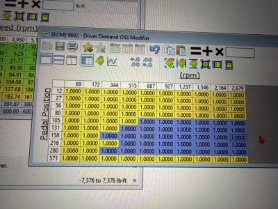

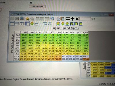

The OSS modifier will take your pedal position relative to your Driver Demand table and say ok at this TP you’re asking for 200 tq? I’m going to only give you 120 tq. So you’d see a value of 0.6000. Or 0.8000. Then like 1/2 pedal it’s multiplying 1.1 or even 1.4. So even if you press harder and reach the top of driver demand you’re sort of already there in a way earlier. It’s just setup to make the car feel quicker than it is in some spots but it also can create the TB to try to close on you here and there if it’s not setup right.
Our demand we want is a peak of 600lb.ft and I reshaped DD so that it’s always pulling equally and I matched OSS Modifier 1:1 so what you ask for is what you get. The car should feel as close to a cable-driven TB as you can get. And it’s mathematically consistent so it’s equally increasing everywhere. It should feel more responsive and just keep giving you what you want with no dead spots. IMG 0891IMG 0892
This is f awesome! This will be how David and I tune my car thread.

Like I mentioned we have scaled capacity high enough right now to watch the car land its back flip in Driver Demand and not get clipped. IMG 0848IMG 0849
When this was set to 1.9 the car hit it and got clipped with PCM intervention. When it was set to 2.2 the car hit it and got clipped with PCM intervention. Now it won’t get clipped but also I don’t believe this is the new ceiling, it’s only the new ceiling for now.

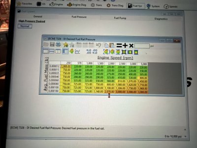

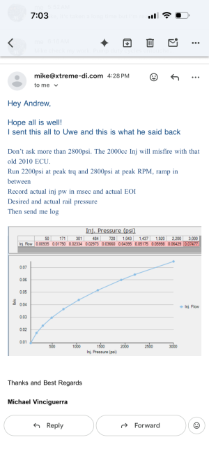

Uwe responded. IMG 0898
I see this up myself. Coming in at 2200psi at 4500 rpm peak torque and ramped to 2800psi for 6500 rpm.
I’ll be getting a log tomorrow.
