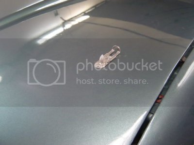

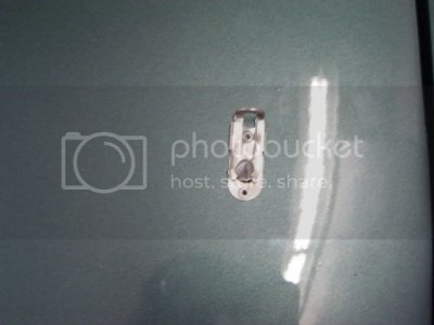

Got mine on ebay , like 10 bucks. but its the really basic ones.
For installing its all about measuring 150 times before you touch anything.

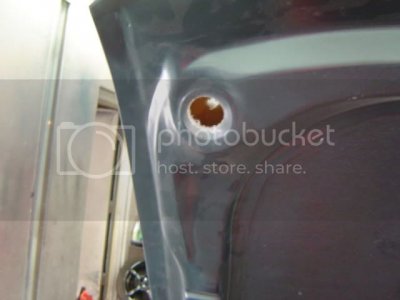

I actually like those pins, I don't want anything fancy. When you drilled the holes does it matter what side you drill from. Looks like I may damage something if I drill from the bottom.

I thought of it but it never happened (yet).
This is a SHOSOURCE hood , and it fits perfectly its only a matter of aligning it , but its not harder then aligning a regular hood.
You need to install the "studs" first , in the area of the hood stoppers , the keyword is MEASUREMENTS.
Once the studs are in I applies some touch up paint to top of the studs and closed gently the hood , and voila I had my makrs to drill. make sure you measure you makrs ON THE HOOD too , to make sure your studs are straight.

I installed the pins first....I then put a glob of white out on the top of the pins...closed the hood and I had my marks for drilling....Worked great....
