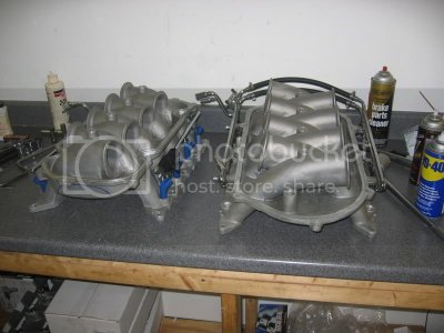

Sorry to hijack but since were on the subject, I don't have a bench flow tester but I did some analysis in a CFD software when I was building my intake, the geometry is not exact because the software will not be able to analyze actual geometry but its close, it gives you an idea of where the velocity and pressure drops are
As you can see the stock intake is a good design but has a good amount of pressure drop which leans out the last cylinders, also the air is pulsating in the intake and the analysis only shows the velocity once its reached a constant flow, like a bench test would. Trial and error will get you in your desired powerband however for me, I copied the Boss 290 Aussie intake, here's a picture I found on the web, shown below on the left, and 2000 Cobra "R" 5.4L 4-valve on the right,

Very Very cool! thanks.. Wondering if your model knows about the v in the begining of the intake that forces the air down each side. It looks like the air is bounceing back causeing distortion. On all of my intakes thoughout the years I have always polished and sharpened this area. and always makes a difference.
