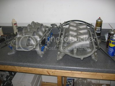

Sorry to hijack but since were on the subject, I don't have a bench flow tester but I did some analysis in a CFD software when I was building my intake, the geometry is not exact because the software will not be able to analyze actual geometry but its close, it gives you an idea of where the velocity and pressure drops are
As you can see the stock intake is a good design but has a good amount of pressure drop which leans out the last cylinders, also the air is pulsating in the intake and the analysis only shows the velocity once its reached a constant flow, like a bench test would. Trial and error will get you in your desired powerband however for me, I copied the Boss 290 Aussie intake, here's a picture I found on the web, shown below on the left, and 2000 Cobra "R" 5.4L 4-valve on the right,
2000 cobra r intake
That diagram is awesome! It’s obviously that the air moving into the intake manifold in the beginning is extremely important to maintaining good velocity around the bend and into the plenums. Most likely knife edging this section could prove highly beneficial.
SHOMETHE$$$
Is it possible to show air conditions at different rpm/flow? 100, 150, 200, 250, 300 CFM?
Also could a smooth transition be added in the Y area of the model to reduce turbulence and increase velocity around the bend, once again modeled?
I don’t know how much time you got….? HeHeHe, evil laugh…
Maybe cut the Y section out and add two TB on the end of the plenum tanks, and model.
We could probably go all day lol…
