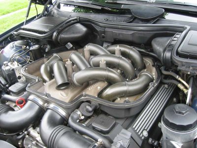

No. Intake runners are tuned to a very specific length to make peak torque at a specific rev point. The reason the SHO has long and short runners is so that it can peak in two places, therefore increasing driveability.
Take a look at this, its the intake manifold of an s62, the V8 from the BMW M5:
M5 intake stacks copy1
Those runners are NOT for noise reduction.
