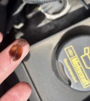

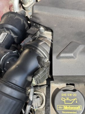

I found a leak on my 2010 sho on the intake hose or the map sensor causing oil seeping onto the motor so im asking should i be worried (bcs of the amount of oil ) and ive got a underboost code ofc. The motor runs fine no blue smoke or oily smell

that sensor is the boost sensor, the map sensor is on the top of the intake. Under boost code can be from a number of different things. That air intake hose being cracked or that noise maker having a leak can both cause that code. Oil coming through that intake hose is common especially without a catch can installed. If you don't have a catch can the CAC can fill-up with some oil causing boost issues and oil in that hose. But you are saying you are getting no oil smell or smoke so not sure thats whats going on.
